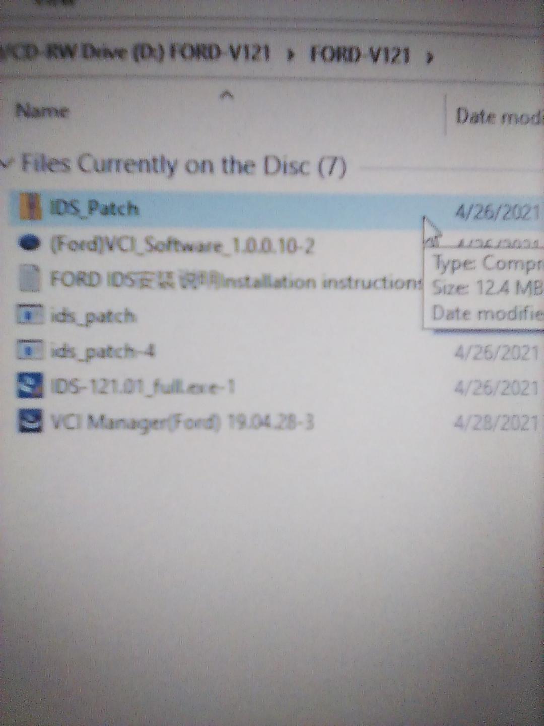

I have removed the Ford IDS software because I'm not trying to do an IDS update anyway. I'm simply trying to use the device so that the PCM and laptop will communicate with each other. I put the j2534 Ford-V121 disc back in the drive to read file names. I was hoping to see a file that would be used to make it function only as a pass thru device. I don't think that I'm seeing such a file.

negative thats extremely unlikely hence why pcmflash exists.
If you find a way to simply read and write otherwise please do let me know.

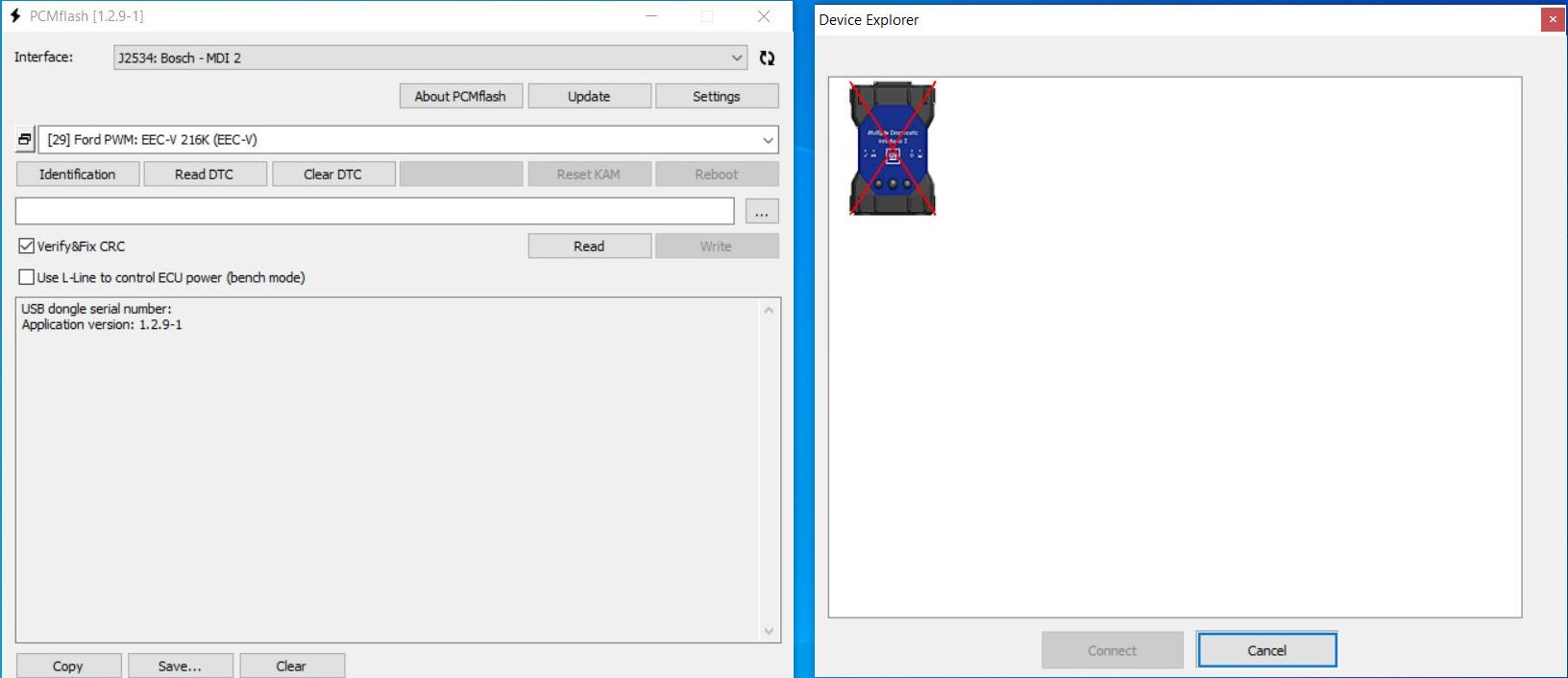

I can't really speak for other devices, but for my MDI2, I had to have the GM MDI Manager installed, and in PCMFlash, select the 'J2534: Bosch - MDI 2' device, then when you click 'read' or 'write', it brings up the Device Explorer where you can select the device. In my screen clip, I didn't have the MDI2 connected, but Device Manager still remembered it, which is why it shows it but it has the 'X' through it.

I do appreciate everyone's input. After much thought and reading, as per Michael's recommendation, I purchased a Mongoose Pro for Ford. I came to the conclusion that I shouldn't be using a possibly substandard devise to be reading and writing files. I hope I can find someone that could use for its intended purpose, the "knockoff" J2534/VCM2 device. Cougar281, even hooked up, I was getting the picture with an "X".
