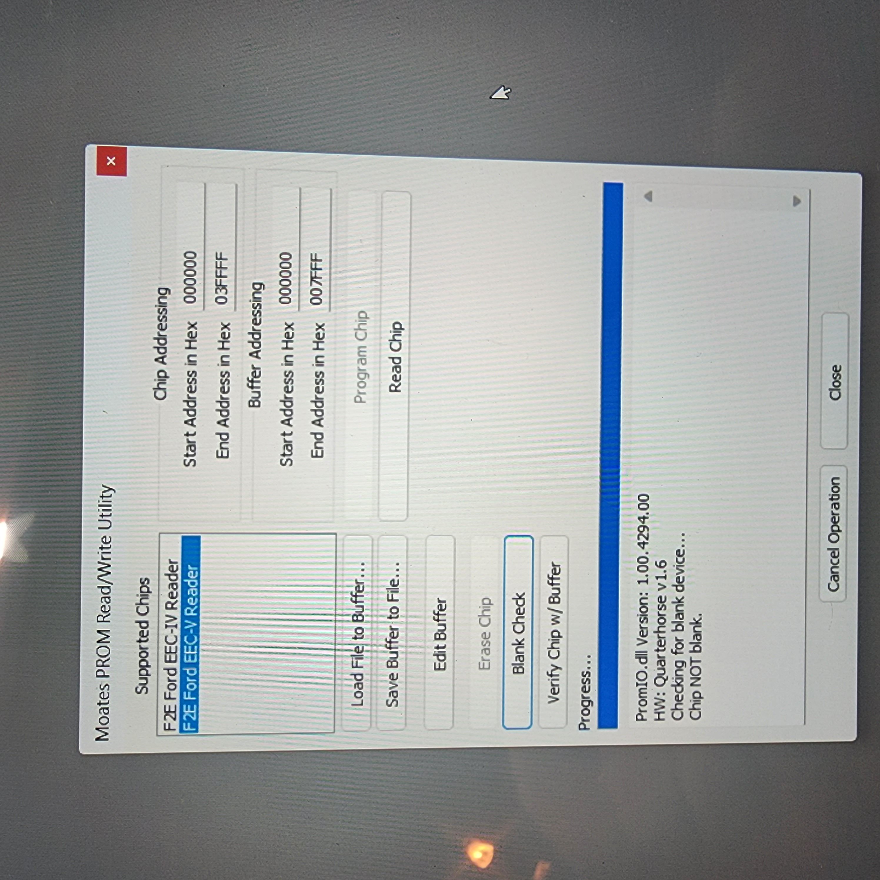

Ok so read the chip and now everything is coming up as blank. I can change the Buffer end address from 07fff to 03fff but I cannot add the 4th f which is in the write up. Leaving the auto populated 07fff in the buffer end address hasn't seem to change anything besides it read more bytes. Either way I only get 32768 byte read with it at 07fff and about half that at 03fff. I read through and don't think I've missed anything but I also don't have the option to choose 256k multi bank file.
