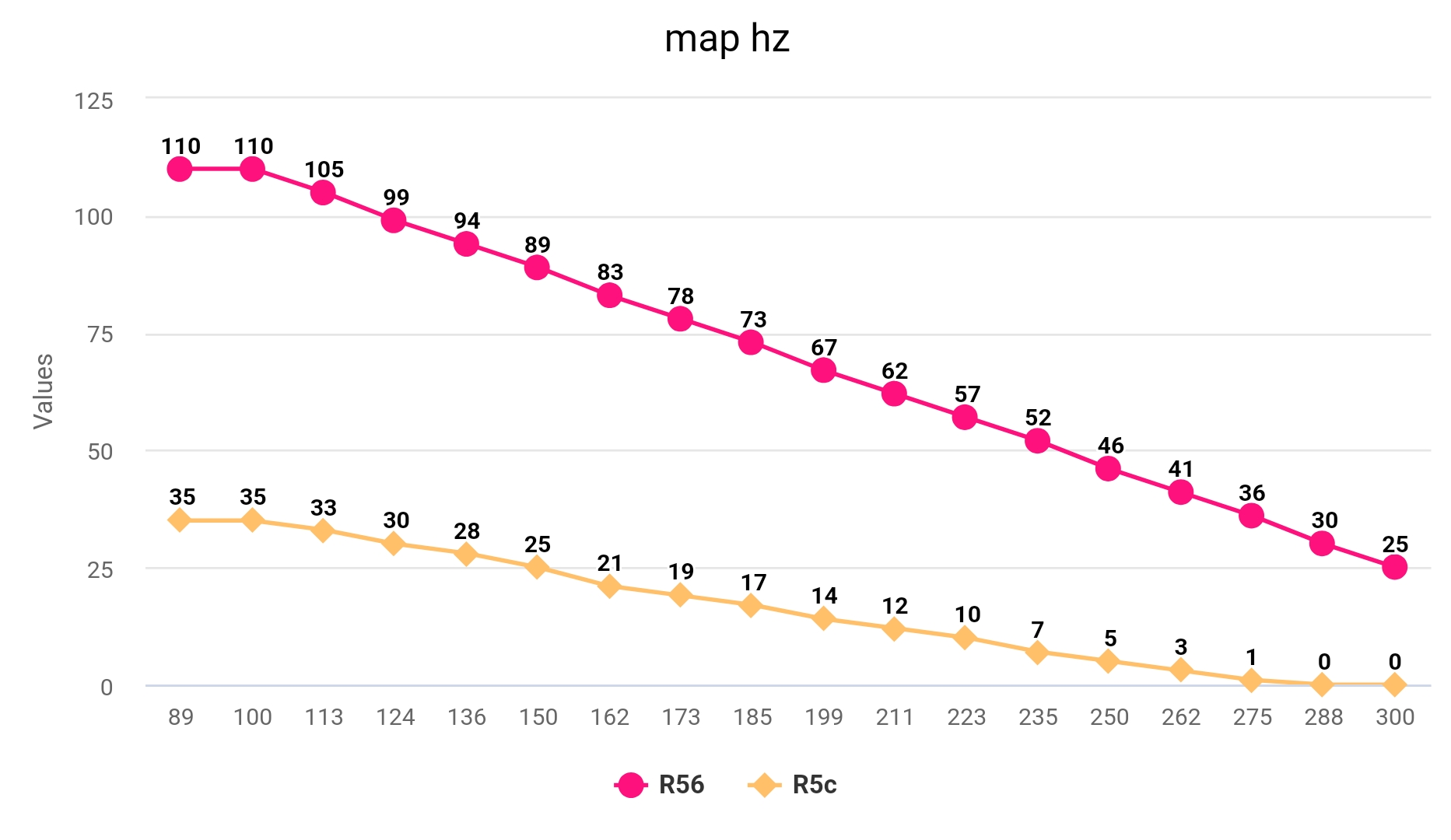

Well based on this I think we can just change some hard coded limits here to allow for more than 162hz. It is literally hard coded to not read anything beyond 162hz (WOT in death valley I guess) This is the A1C MAP Subroutine. I tabbed out the if statements and converted the words to decimal and divided by 256 to get the values. C code only down below. We should be able to determine what R56 and R5c represent and set appropriate values for boost. Seems easy enough unless this is just the tip of the iceberg.

Posts: 423
Re: Bench Testing MAP Sensor - Boost
Thinking about removing all of the nested if statements and adding functions to lookup values for r56 and r5c. It should look something like this:
Thoughts?
