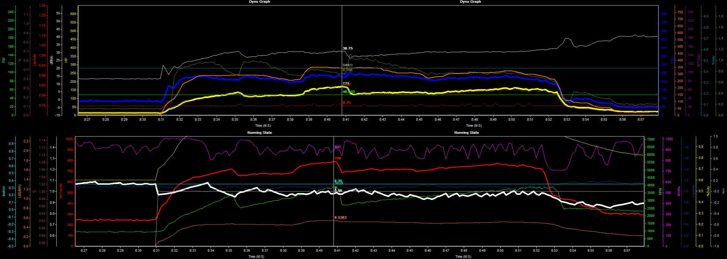

No log today, but here's a screen shot of a very solid pull, Lambse's are very stable, and with some more tuning, it'll be even better :D
Also I've included one of the most current Bins where things are pretty solid in case say you followed and are curious to compare them ;)
