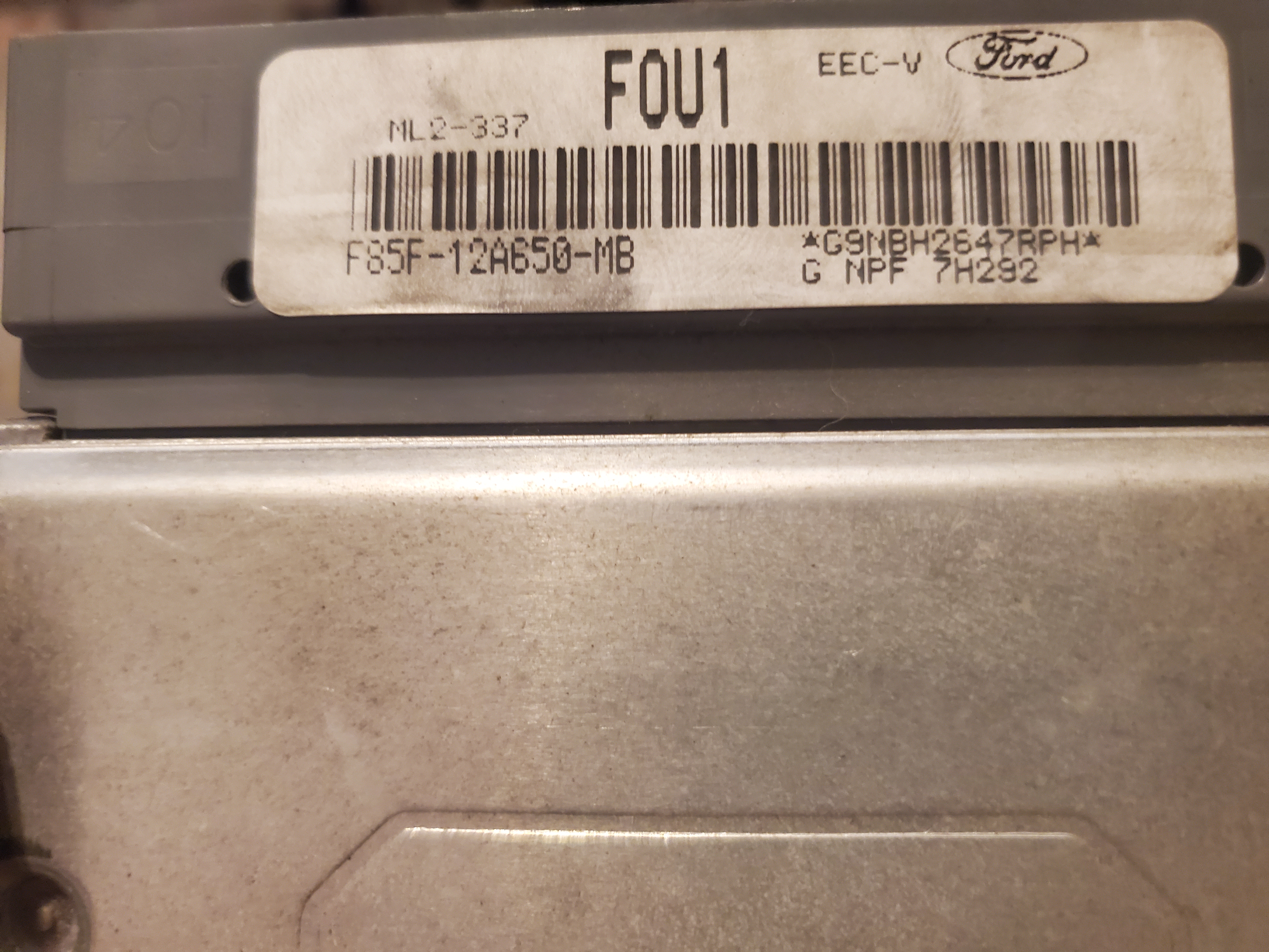

Well
FOU1 ran with fha3
But it was extremely unhappy and ignored a lot of inputs from the tune with the low speed fan running 24/7
Also to note, random speedo and exterior light fluctuations
Good news is it ran as good as it ever has.

- Posts: 7118
Re: PCM troubleshooting
that means it has a different bidi port mapping so its not interchangeable
The 98 marquis will work right?
- Posts: 7118
you can plug the hardware code on the homepage under supported ecus and it'll tell you
Ok, its supported.
What bin should i run this under?
Its a vtc5 out of a 98 marquis
- Posts: 7118
why not use the same bin youve been using?
I thought your purpose is replacing it with the same ecu was so it was plug and play?
Idk if it needed the auto v8 bin or what
Shit, plugging it in and sending with fha3
