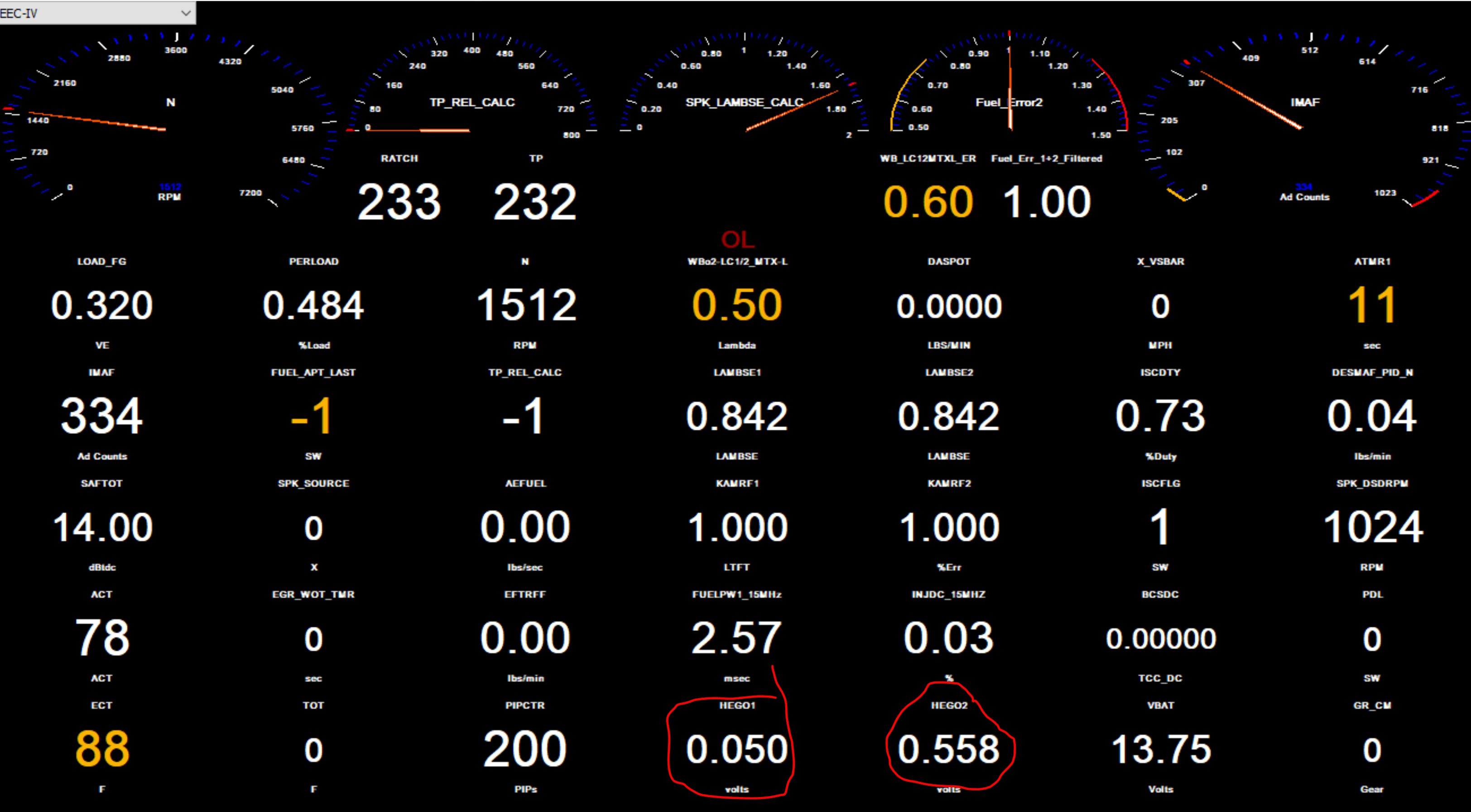

Yeah pump shuts off after 3s of priming, how do I verify it's communicating well with the ECU?
I'm kind of wondering if I have a bad HEGO, or stuck injector or something on Bank 1, as that was where the #1 cylinder filled up with fuel.
Bank 1's HEGO volts are a LOT lower than bank 2.
