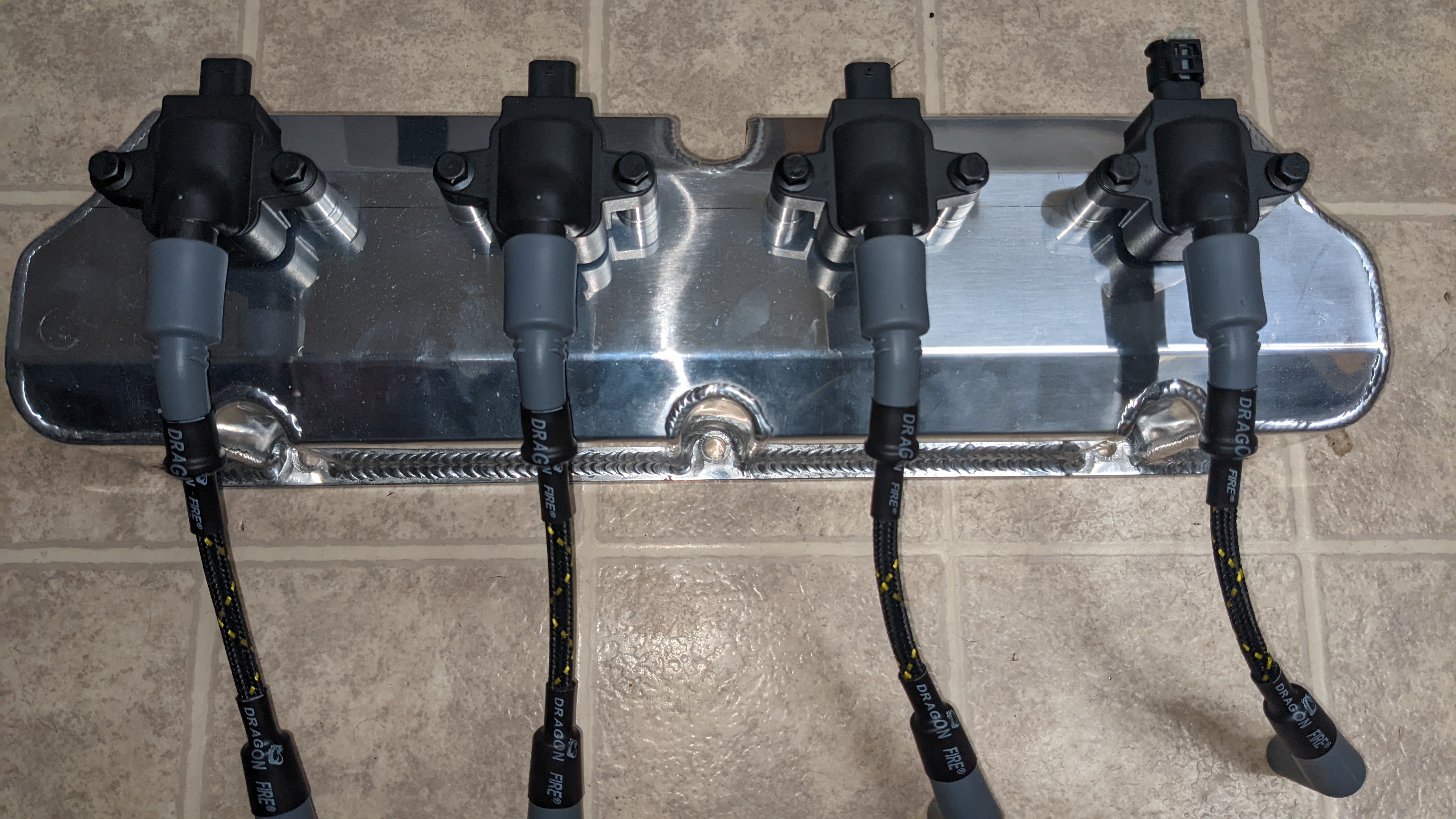

Coils and wires showed up today. I wont be using the plug wires included as they are too close to the headers for me so I am going to order some short boot LS 135 degree wires and call it good. I tested the other set of LS wires I have with straight boots and they fit the coils perfectly, but they are too close to the headers too.
- Posts: 471
Re: Mustang SBF EECIV to EECV Swap
Below are the plug wires i ended up getting that i can confirm will work. They positivity lock on the coil terminal and clear the headers. The boots are nice and tight. They basically fit like a stock plug wire at the plug and are the perfect length for tall valve covers on a SBF with coils mounted on the valve covers. They are 9.5 inches

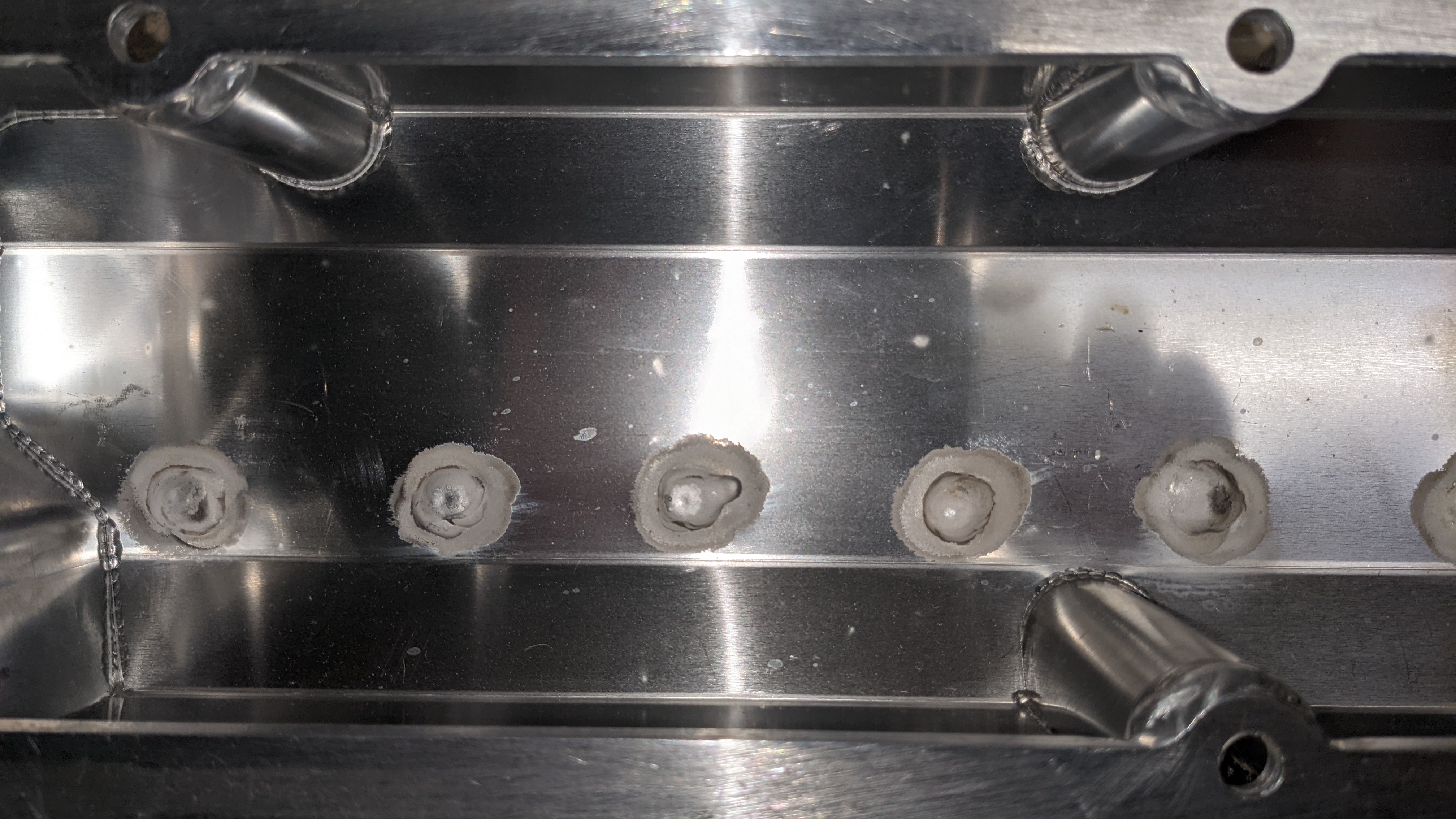

Honestly no... I'm helping my friend build a coyote powered fox. All my spare time has gone to that. I did get the valve covers done and now have the coils mounted on them.

The Godzilla coils look absolutely fantastic on SBF covers, great work dleach!
