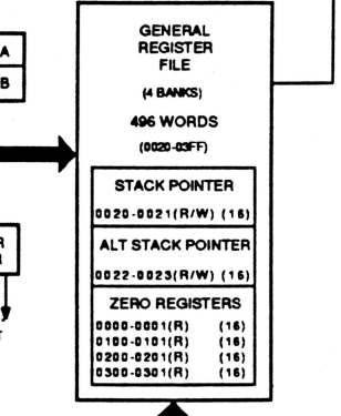

Ford are quite happy to refer to the registers as 0020 to 03ff.
R13A is a valid description, I'll continue to describe it in that manner.
Feel free to call them whatever you like.

Of course R13a is a valid register, byte value located between R139 and R13b.
Its byte location is R13a, size of one byte.
Its word location is R13a, size of two bytes, hi byte being R13b and lo byte being R13a.
Its double word location is R13a, using up four(4) bytes in memory R13a, R13b, R13c, R13d.
