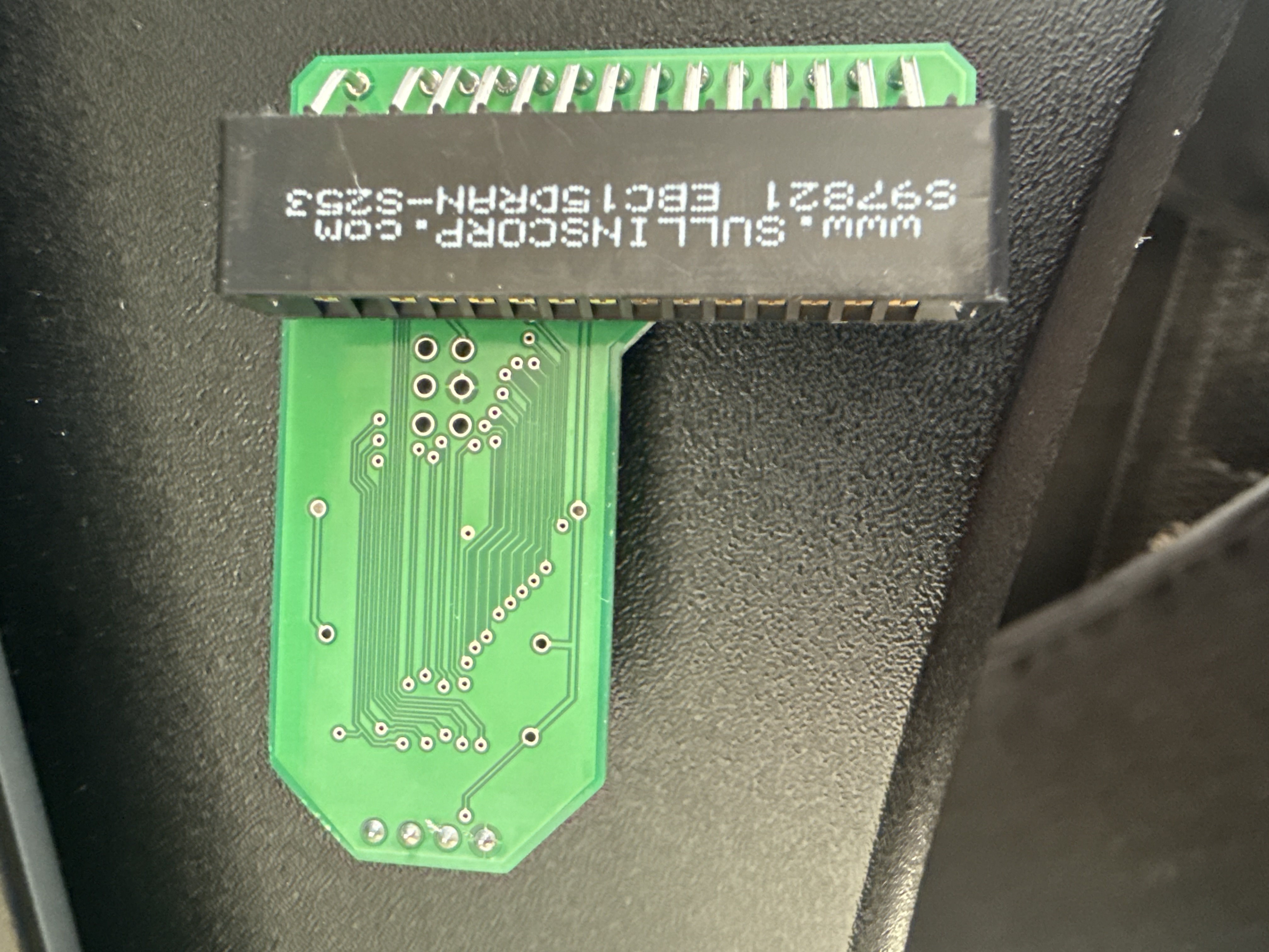

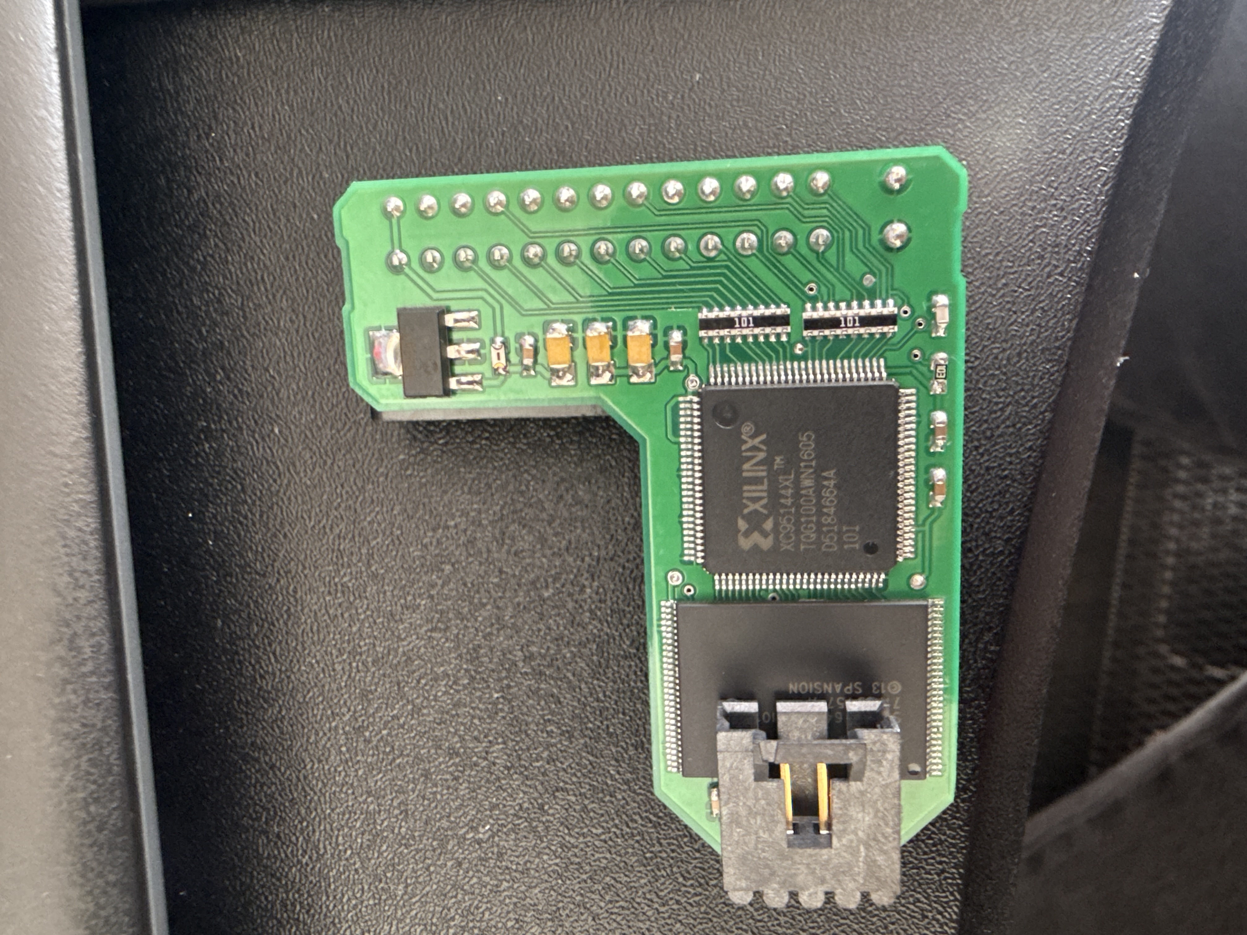

wow thanks guys. I may be blind don't see the jumper solder pads on the f3v3. I'll post a pic from my phone

f3v3 auto switches the pats code if you write a 4 bank tune.
Youll need an f3v2 or get one modified. Craig said shoot him an email if need be.
