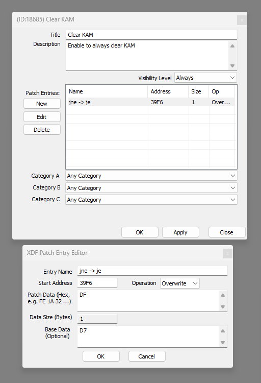

KAMQA is the first KAM address [700]. FWIW here is a simple patch to always force KAMs to be reset.

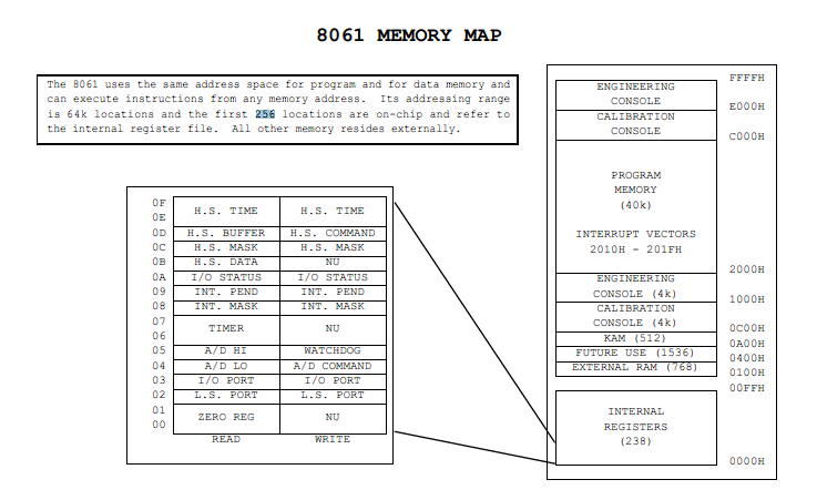

If this screenshot is accurate the KAM Locations are from [700] to [8ff] but only [700] to [7b7] are being used.
Only the 6 ISCKAM and 106 Adaptive Fuel locations are checksum'd (stored at [702] for ISC and [74C] for fuel). The remaining KAM locations are assumed to be correct unless KAMQA-KAMQC are found to be different than their initial special pattern values.
