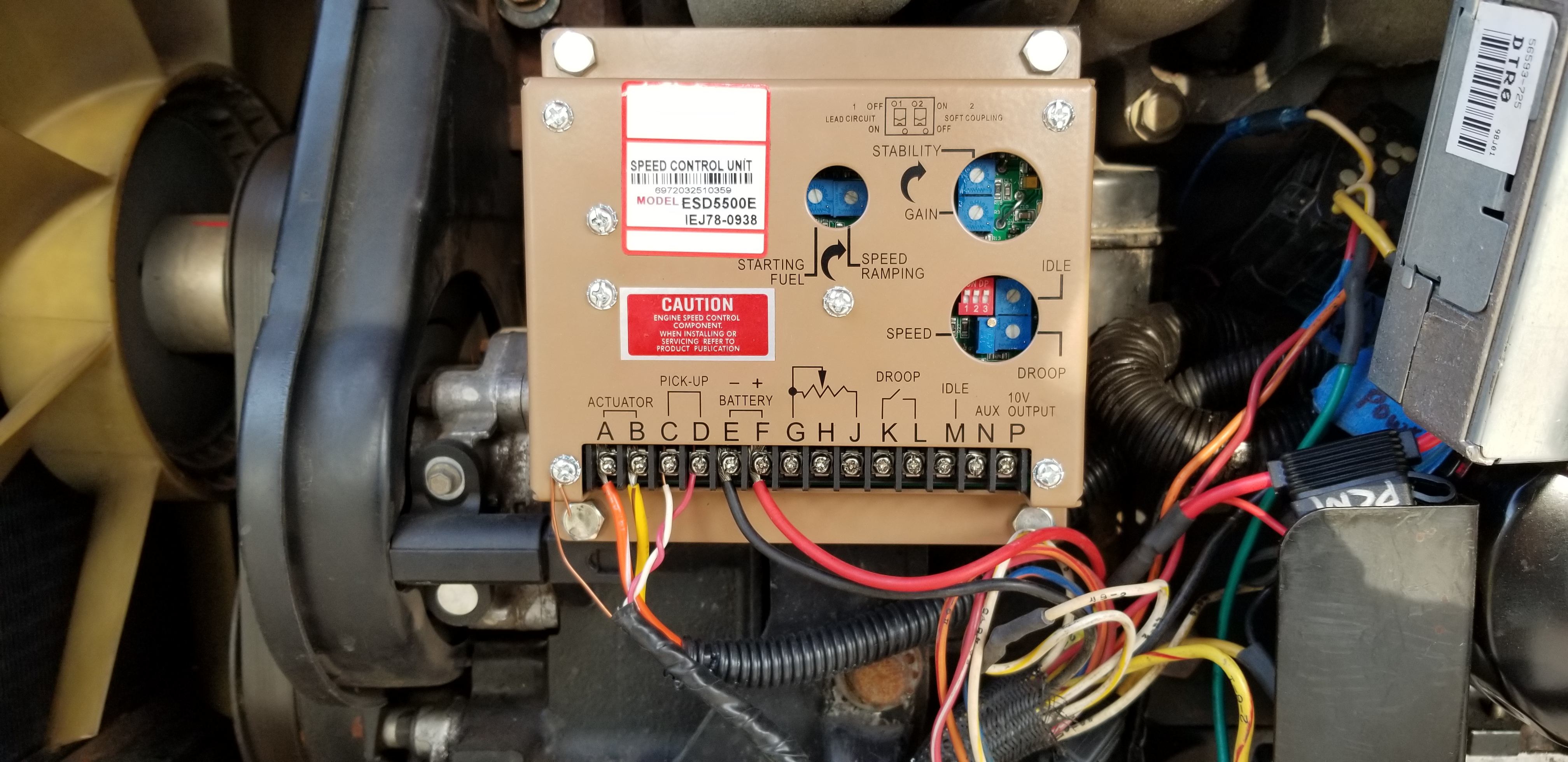

I think this Brown Box is the governor:
- Posts: 417
Re: Need custom EEC-V tuning for governor operation
Here is the instruction manual: Now that you have the engine running, you just need to configure the majic brown box,...maybe?

- Vehicle Information: 2003 JLG Boom lift 2.5L Ford EFI running on a 1998 Ford Ranger EEC-V XL5F-12A650-DA DTR0
I tried all different adjustments of the governor. I could never steady the engine. It's like the engine timing was all over the place. Near idle it would be 10 degrees restarted. Just barely touch the throttle and timing would jump up to 20 or 30 degrees advanced. RPM would jump by a 1000 RPM or more. Is there a way to lock the timing in the Ranger computer?

I am assuming that is with the actuator installed.Acesales wrote: ↑2022 Oct 26, 21:36 I tried all different adjustments of the governor. I could never steady the engine. It's like the engine timing was all over the place. Near idle it would be 10 degrees restarted. Just barely touch the throttle and timing would jump up to 20 or 30 degrees advanced. RPM would jump by a 1000 RPM or more. Is there a way to lock the timing in the Ranger computer?
How many hours? Hows the coupling?Fast erratic governor behaviour may be caused by very soft or worn couplings in the drive train.
Hows the speed sensor pickup, tested to be within spec?

it looks like G H and J should be connected to a throttle sensor so the governor knows where the throttle angle is. And there's Droop? IDK what that
is. Has a switch symbol.

Droop could be a time out switch where the rpm goes down to a low idle when engine is not loaded.

The erratic RPM is without the actuator connected. Moving the throttle a few degrees causes s big jump in RPM. If you quickly release the throttle it still hangs higher then slowly comes back down after a few seconds.
The couplings are new Heim joints and tight. The speed sensor detects ring gear teeth. It generates an AC voltage. I measured around 4 to five volts while running.
GHJ are for a remote potentiometer. Same as adjusting the RPM pot inside the governor unit.
From what I've read droop allows the engine to lag in RPM response. It's mostly used for AC generators running in parallel, or synchronous operation. Also prevents RPM "hunting".
I returned the governor thinking there could be something wrong with it. Seems like with chinese products the customer is now quality control.
