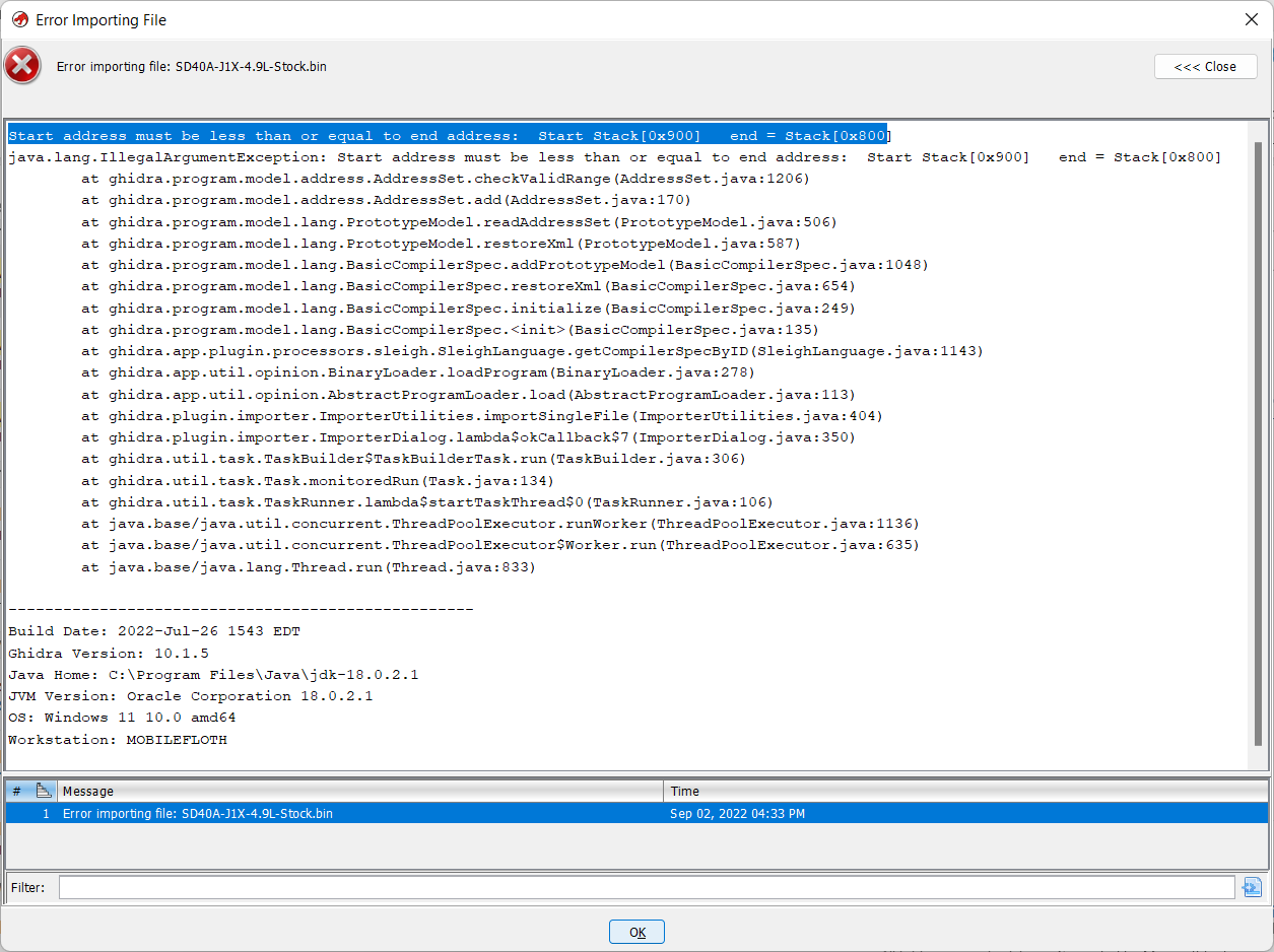

This is really cool. Programming in assembly is not for the faint of heart. This could really open the doors to understanding the code better. I tried to get this working with my 56k bin but I keep getting this error
Start address must be less than or equal to end address: Start Stack[0x900] end = Stack[0x800]
I added a 0x2000 offset to the bin and configured it the same way as the screenshot. Not sure what I did wrong here. I just copied the sleigh files into ..ghidra\processors\806x

Looks like the download.zip has issues, reason is the .cspec file is wrong.
Stack space should be defined as:
 <range space="stack" first="0x0800" last="0x0900" />
not the other way around.
Get the latest files from github:
https://github.com/mercury64/Ghidra-EEC-806x
