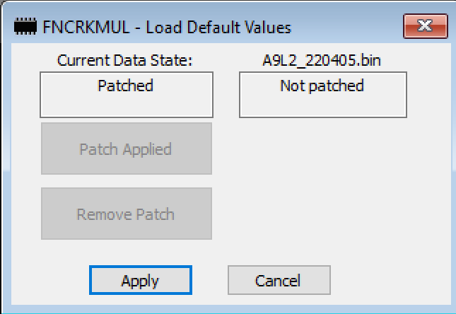

Sean,
I'm in the midst of transferring my older A9L2 tune to the A9L2_220405 and am having issues with cranking PW. I am curious if you ever encountered this:
I may have made a mistake of patching my bin file with this and now I've got some problems.

anytime you run in to that remove the patch and then re-apply it and do a compare to the file to see whats changed
the cranking pw multiplier function is probably modified from the patches base values.
the cranking pw ect modifier function cannot be copied from an old tune to the new a9l2 since its completely revamped.
just simply apply the arbitrary cranking pw correction to the base a9l2 values for your engine size and injector size differences from stock 302 and 19 lbers.

When I go to apply the patch, I get the following error:

impossible to know whats going on without the file being posted

Re: again with FN348 Cranking Pw ECT questions
So what I've got working at this point, is simply modifying FN348 and also modifying FN306, which is labeled as being "depreciated." Car runs great, but Mike you may want to take note of the issue described above. I've confirmed the same results on 3 separate computers running TunerPro RT and the currently posted A9L2 bin file.
yeah just the last value multiplier of 0 at the top of the crank pw multiplier is what shows as the error since the patch was with it at 1
makes no difference
makes no difference
