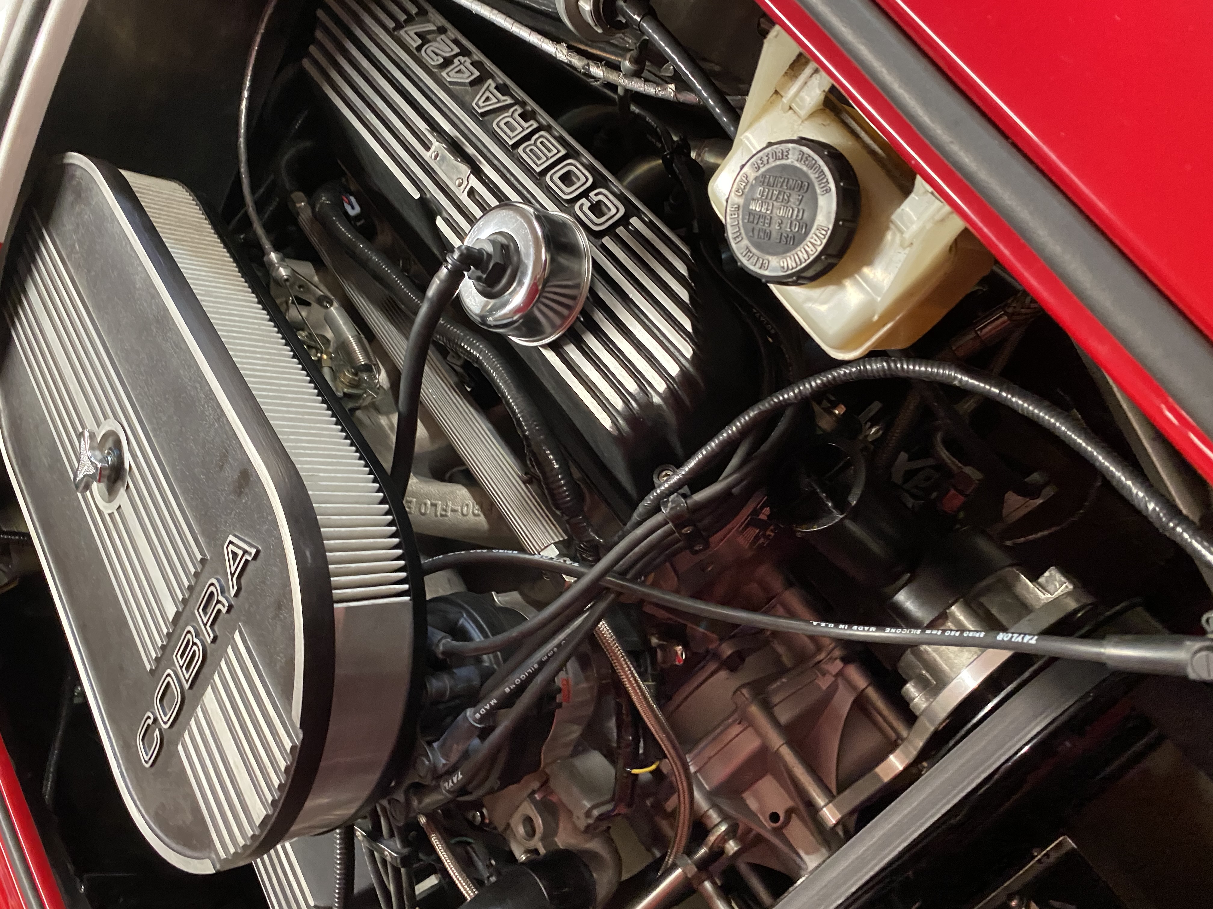

It's not that different from what I'm running. Mine's an Edelbrock gen 1 Pro-Flo intake manifold which has been described to me as 'like' a Victor Jr but with slightly smaller ports.
It's all I've ever run but I've never been aware of a shortcoming that can be attributed to the intake.
