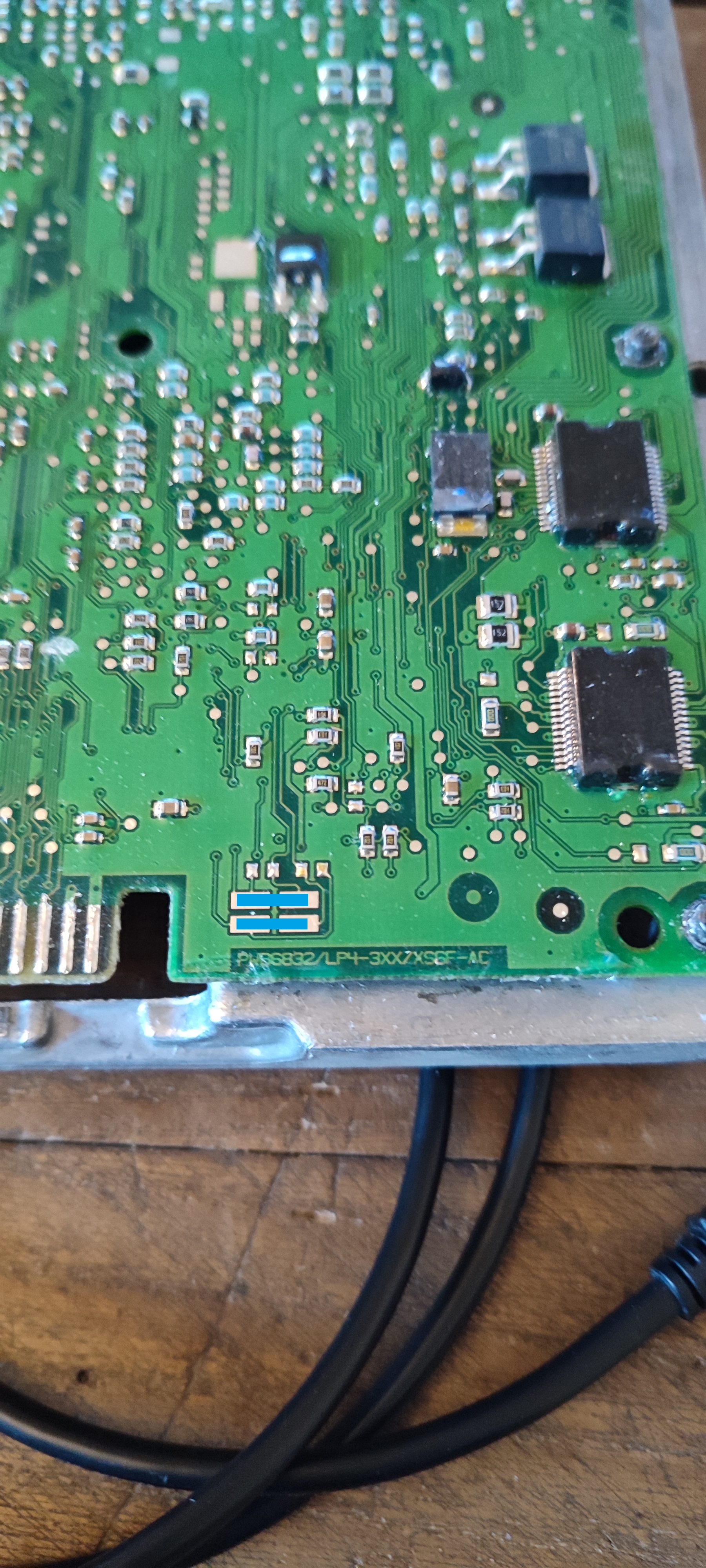

Is that LP4-336 hardware?

Re: convert 224K to 256K
is LP4-332
i have test on over 4 bank LP4-323 (i have 4 pcm for test) same result
I see on the board 4 jumper near the J3 port did they need connect?
SOLVED!!!
need to connect the jumper like this
now F3V2 work
thanks for help
now F3V2 work
