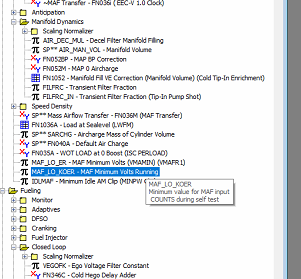

I was moving through my tune here since the MAF swap and noted this parameter . KOER the MAF AD counts tends to be below this minimum value. Should i strap this value in the parameter below that of it or does this function effect something else ? What happens when it dips below this value ?

whats the pid?
what does the comments say?

[attachment=0]maflower2.png[/attachment][attachment=1]maflower.png[/attachment]

I believe this would only effect the Key On Engine Running self test and make no difference during normal operation.

interesting. so now its above my MAF minimums still though and its for Key On Running , so i feel like it would cause some effect or another . Im certainly not pushing 100ADcounts on Key on not running and only when the AC is running am i above that at idle
