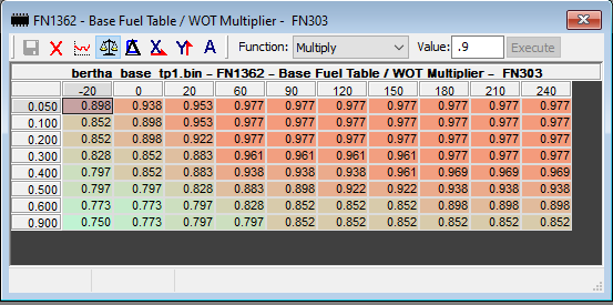

Base fuel table and example log attached, for anyone curious.

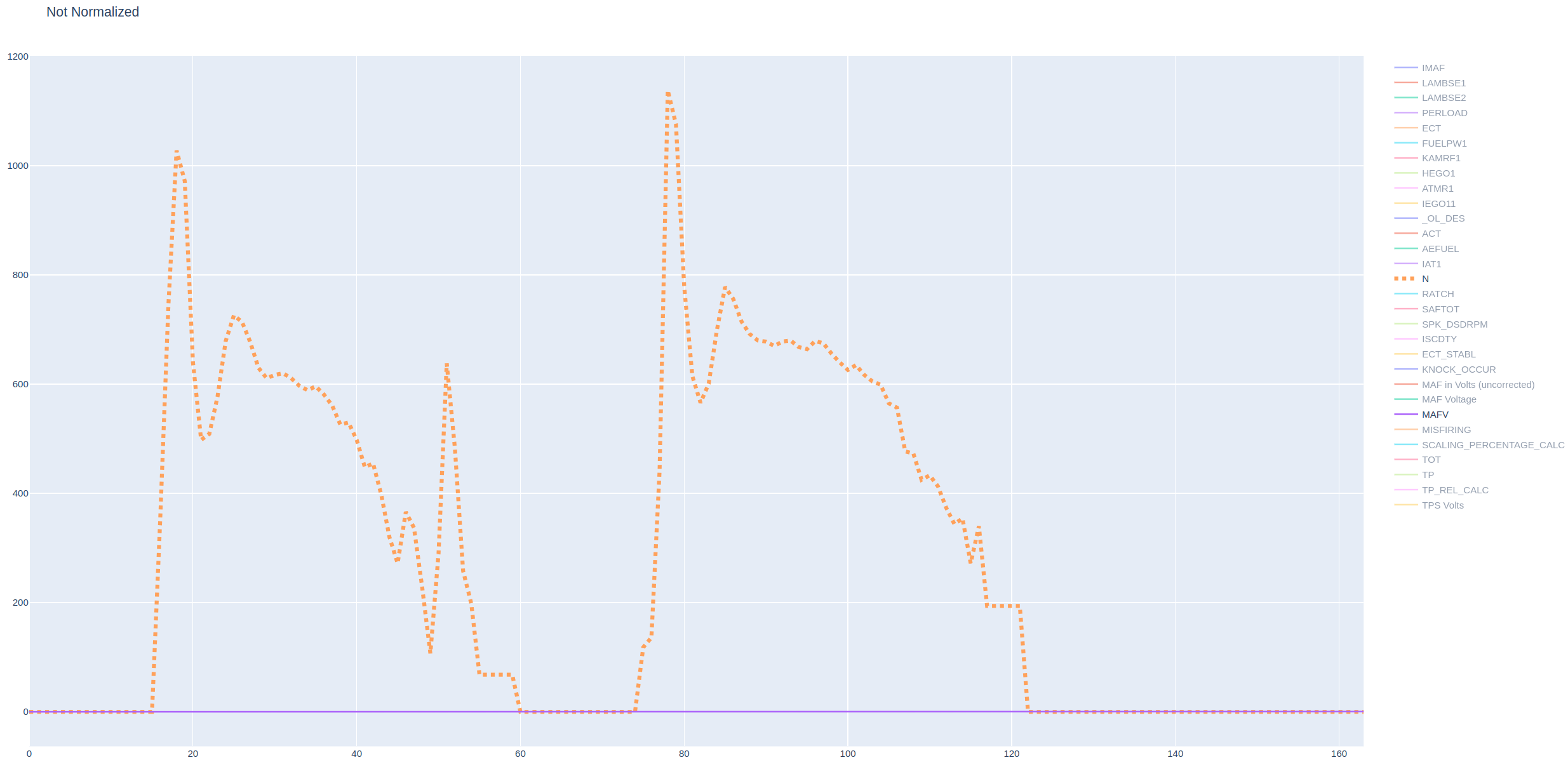

Turns out it isn't going lean, I pulled the plugs and they were all carbon fouled and soaked with gasoline. I'm guessing my wideband reads lean because the mixture is so rich that there's incomplete or no combustion (explains the thick white smoke that doesn't smell like coolant). But I think I found something interesting: in the attached log plots, engine fires up for a couple seconds, then dies (twice). You can see that as RPM (orange line) drops, MAFV (blue line) actually increases. Here are the RPM and MAFV values normalized to [0, 1]: And here are the raw values, MAFV voltage roughly in the range of [.6v, 1.1v] while RPM decays from ~1k to 0. FUELPW1 (not shown) tracks the MAFV voltage so the ECU is definitely dumping excessive fuel as if it thinks its lean: Does this look like a bad MAF signal, or are there circumstances where it makes sense for MAFV to go up while RPM drops?

fuelpw is irrelevant but is supposed to increase as rpm drops
but if mafv is increasing as rpms are dropping then that means the engine is loading, if your not on the throttle then the maf is probably bad

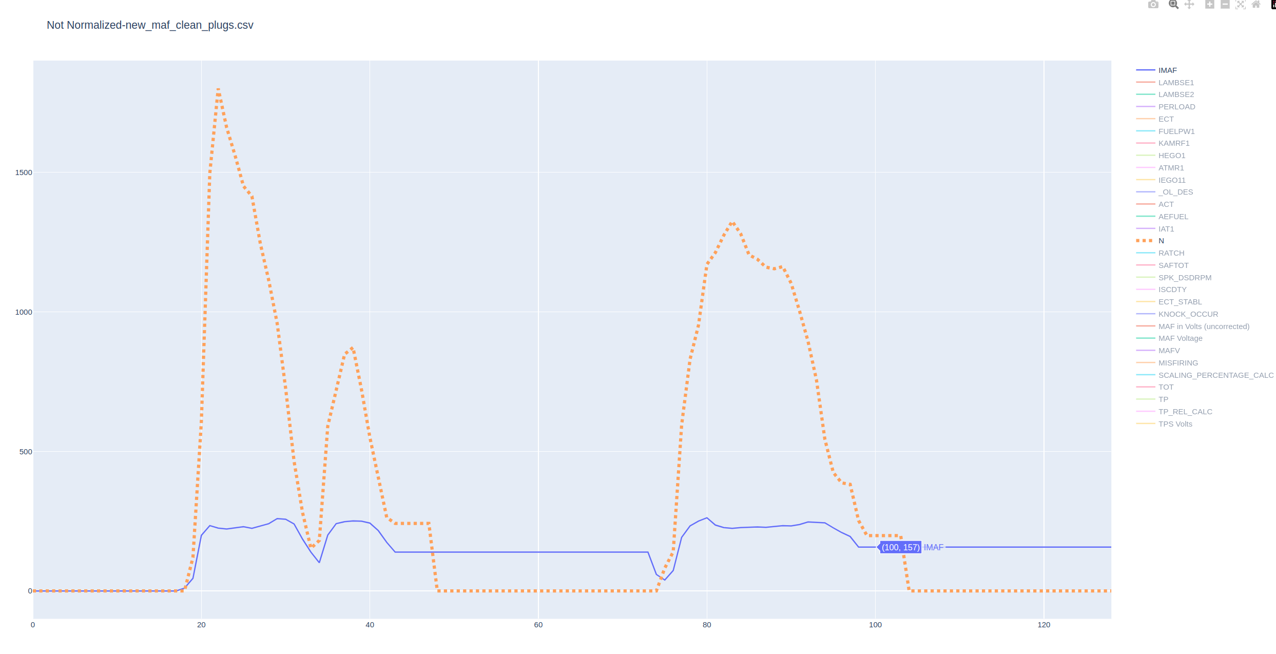

With clean plugs the engine would start and idle (very rich, as expected) with MAF unplugged, so I swapped out for a new MAF sensor, no improvement. I did notice something else about the signal now (see attachment), this time MAFV curve does not track the shape of the RPM curve. MAFV stays flat while RPM rises and drops sharply - would expect both to be roughly the same shape, so maybe there's a bad connection between MAF and ECU? Also, MAF+ pin at connector reads 5.8V with sensor unplugged, not sure if that's far enough out of spec to cause a problem (should be 5V as I understand).
At this point I have done the following:
New MAF sensor
New ignition module
Swapped in old but working dizzy
new IAT sensor
Swapped in old but working coil (in case the problem was weak spark)
Verified MAF connector power voltage, input voltage, and ground
Verified fuel pressure during cranking (set at ~45PSI as recommended for the trickflow injectors)
Unless I'm missing something it looks like ECT sensor and ECU are the only components I haven't tried replacing yet, but this would be an odd failure for an ECU...However if the 5.8V MAF+ voltage is the problem then that would implicate the ECU...
In attached image, orange line is RPM, blue line is IMAF, note how IMAF levels out while RPM rises and falls.

if its rich then lean it out
simply go to the startup enrichment table and 0 it out for now so u can see whats going on
you do have your crank pw adjusted correctly for your engine and injector size correct?
