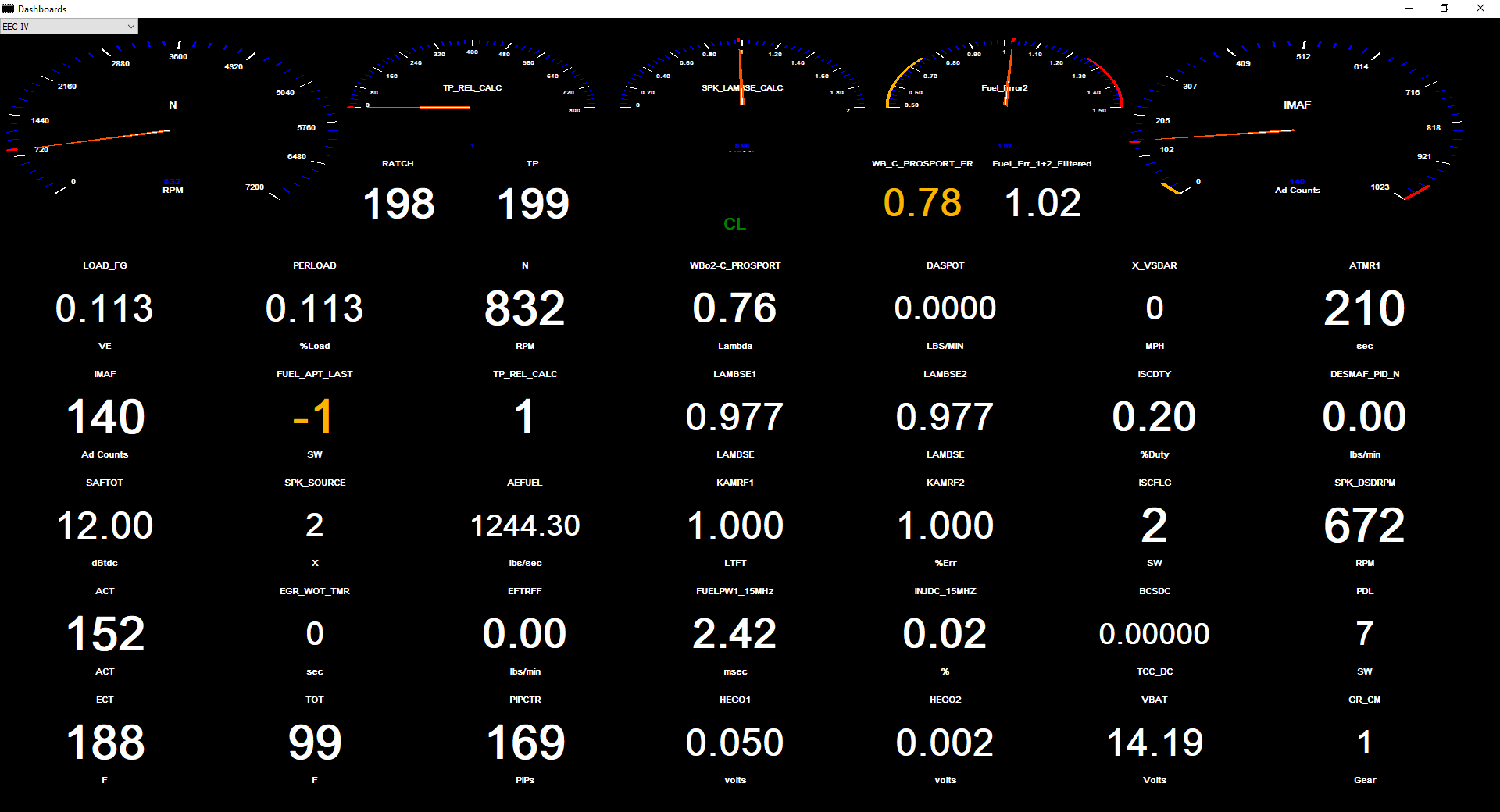

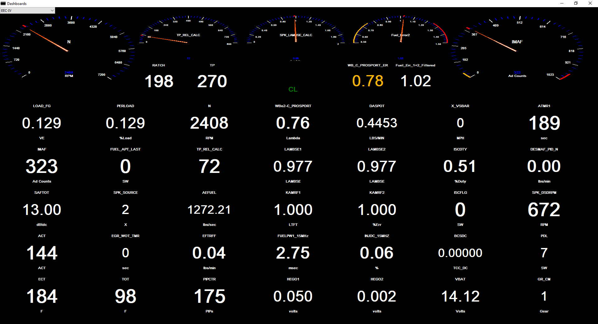

Re: Running Lean
I'm all set up and reading real time data, thanks again for the help. I can now confirm that the ECU does not command more than about 12deg SAFTOT at 2-3k RPM, and hangs around 4-5deg at 1500 RPM. I've attached two screenshots of the dashboard, one at idle and one at 22k rpm. Both tests conducted in park, engine warm. Does anything stand out?
One potential issue, HEGO values stay pegged near 0V regardless of RPM/throttle position/throttle movement, even when my wideband (not hooked to ECU) reads 12 or less. That would potentially cause ECU to pull timing, right? HEGO signal is good at wire, going to verify that it's on the right ECU pin shortly.
- Posts: 7112
Re: Running Lean
the hego voltage may not be logging you can verify by lambses ramping up and down in closed loop

big_bertha
- Posts: 18
- Joined: 2022 Feb 27, 18:50
- Location: Houston
- Vehicle Information: 1990 Bronco, 351w with MAF swap ('94 computer, calibration DIX0, part number F4TF-12A650-BEA), 36# injectors.
Re: Running Lean
For anyone who might have a similar issue later, it turned out to be that I had the O2 sensor plugged into the wrong harness. Thanks for the help.
