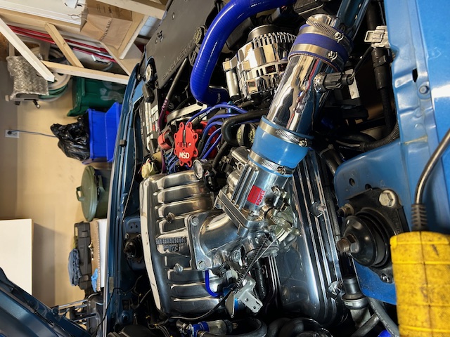

Ok loaded my T4M2 Tune into the car and have a couple of issues
1. Noticed my Maf is lean and had to add 30% to the entire curve which was within 1% Kamrf on the J4J1 strategy.
2. Maybe the PROm curve i had was incorrect as i did not have a print sheet with it. It is a fender style since it has a flange with 4 bolt connectors and the Maf itself says recalibrated on it, and have it connected directly to my KN filter inside the engine bay.
3. My idle is not stable and stalling while engaging the clutch at times in forward and reverse
4. I have slight surging when stopped at times and stable at other times.
5. My Kamrfs are within 5% at the moment.
- Posts: 7106
Re: T4M2 Strategy with TunerPro is an Awesome Start but stall Issue
for it to be off 30% you had to input something wrong somewhere
the rest of it just dial it in
