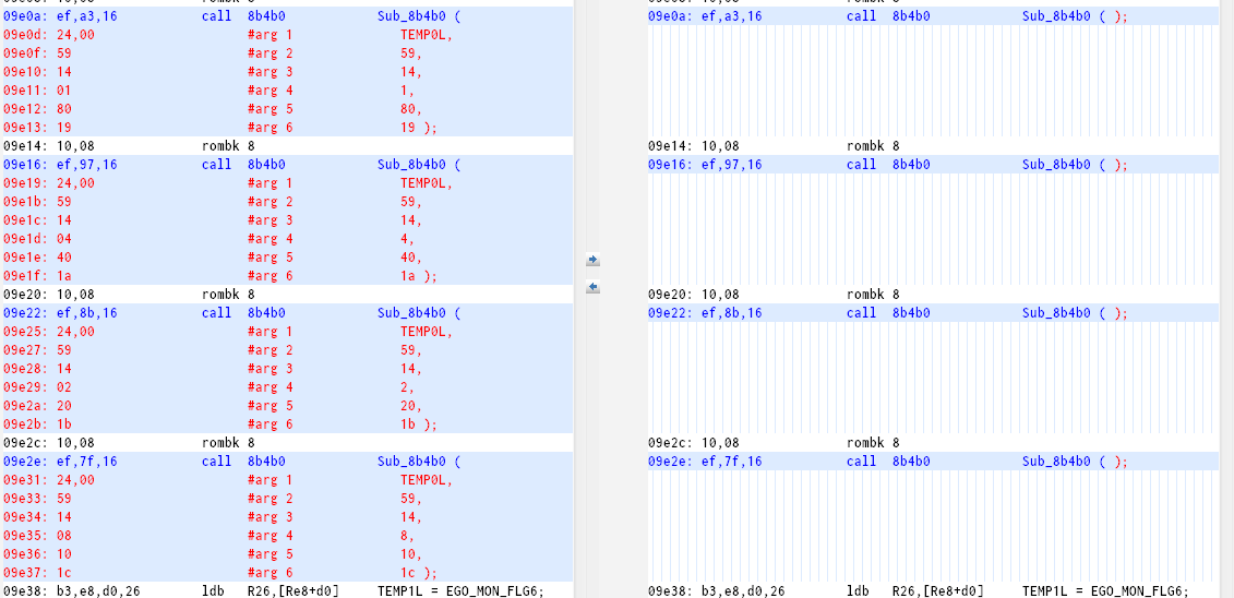

BOOSTEDEVERYTHING wrote: 2024 Mar 21, 12:57 Also.. I think somewhere in the mess below is the fault code list, But I am not sure exactly where and how to make sad see a big area of what it thinks are tables, as words. And where to start and end exactly. Can you please help with guiding me towards this as well? I will go ahead and also post a zip of the bin and dir files i am using for reference. Thanks again
I think the fault code list starts around 19596
Code: Select all
19596: 20,04,30,04,60,14,64,14  table   32,   4,  48,   4,  96,  20, 100,  20
Use the word command, as I have in the RZASA DIR previously posted in this thread.
Code: Select all
WOR 19596 1973D
Search the LST for immediate values.
Comparing OMAE2 to RZASA, I've sifted previously, you'll find a matching sub.
Failing that I'd search for 13,01 and see if other codes are nearby, from there make my best judgement.
Eventually, enough code can be identified to confirm best judgement. One could confirm actual table end to infer fault code list start.
Another immediate value indicates the start of the next block of data. Make a judgement about the end of the previous. Time will tell if that is correct.
Code: Select all
0b62c: 65,3e,97,2a        ad2w  R2a,973e         TEMP3L += 973e;
Beware 5.08 leaves out lots of args.

Unread post by BOOSTEDEVERYTHING »
I think I found my overlap issue now that you have explained it a bit. Now, to fix it, do I just delete the first one in this list or delete the ones after it and let SAD figure out the code? Not sure if there is a point in adding all the separate entries or if a range is better? Thanks
Code: Select all
code 8fce8 8ff99
#code 8fcfa 8fd2f
#code 8fd30 8fd53
#code 8fd6c 8fd71
#code 8fd90 8fd95
#code 8fe1a 8fe25
#code 8fe44 8fe5b
#code 8fee6 8feeb
#code 8fef8 8ff33
#code 8ff4c 8ff5d
#code 8ff6a 8ff75
fill 8ff9a 8ffa6[code]
