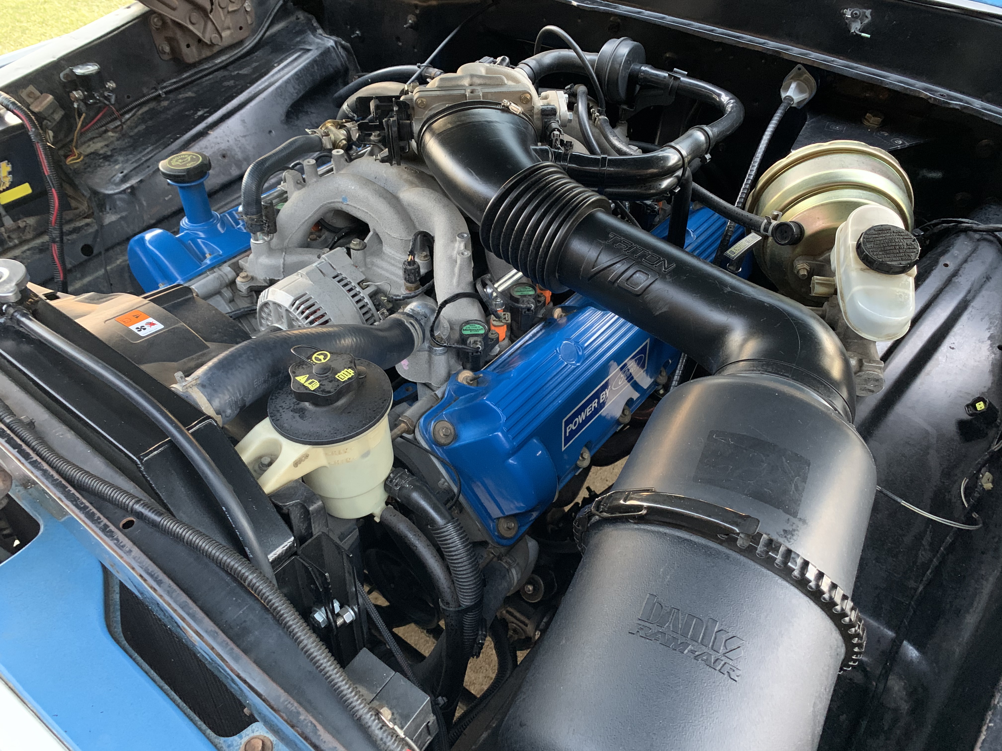

old thread....but a few years ago i dropped a 2v into my 1970 F100 with a TR3650 5sp, decipha did initial tune and it's been a blast to drive @ 3800lbs. :D
#v10bumpside #v10f100
