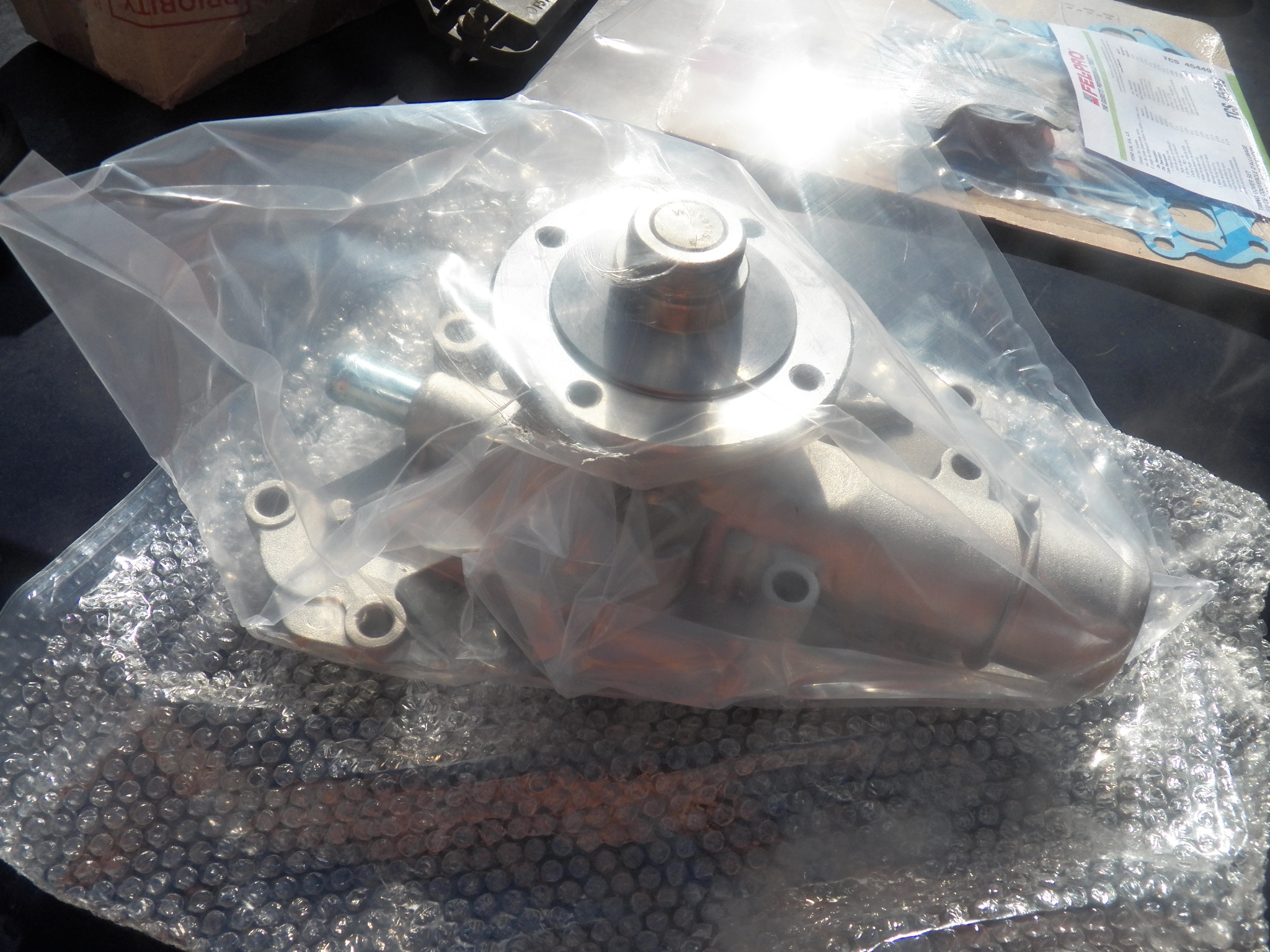

I have bought several maintenance parts to replace while I'm doing the conversion. New water pump, timing chain and gears. Fel-Pro gaskets etc.
One thing that always has bugged me about this truck is an FL1A filter will not fit it, and it had a pass thru cooler thing that I wanted to remove. So, I purchased a block/filter adaptor, 3/4-16 I think, that fits an FL1A filter. I also bought an oil filter relocation kit.

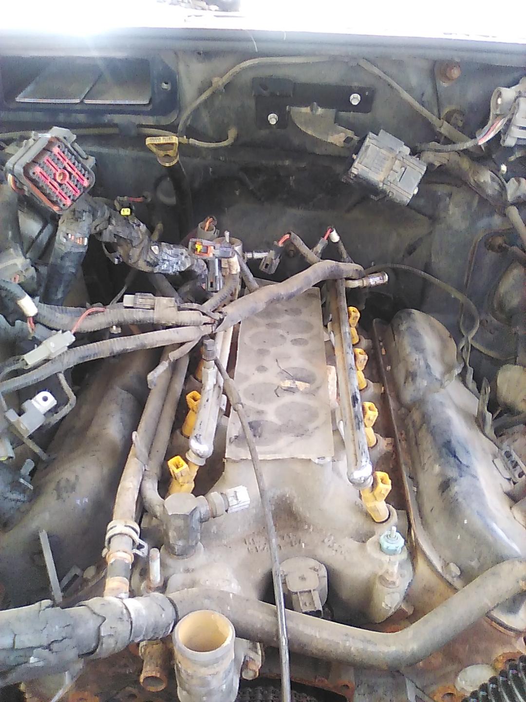

I'm still working on removing the entire powertrain harness from the MM. My Explorer comrades that I have, say to remove an access panel that is located beneath the console to access the connectors for the O2 sensors and transmission connections. FUN. Not bad really with the instructions. I already have the '99 Crown Vic harness removed and will be fashioning a "hybrid" harness out of the two harnesses.
I should be hearing from the fab guy before the end of the week, and I would like to remove the RH valve cover and modify it and have it back on in the same day. I'm looking on google for a 1/2" steel pipe thread bung.https://www.google.com/search?q=1%2F2%2 ... nt=gws-wiz I didn't think that I would find one so easily. That's the piece I need for an oil fill hole that a long skinny transmission funnel will fit in to put motor oil in this machine. More on that next time.

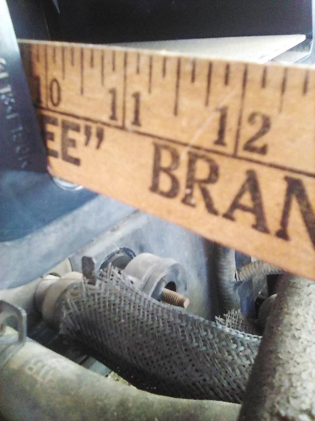

While I was there, I wanted to know how deep the "pocket" for the PCM is. The Moates QH sticks out of the PCM about 3/8". I was using a ruler to see how deep it is and discovered that it is open in the back. Maybe there is room to get the cable from the Moates to the laptop via this opening.
When I was measuring, I discovered that the pocket does not have a back.
I contacted an Explorer friend who has his dashboard removed form his truck during a full build. In the picture you can see a little vertical bridge. It would interfere with the Moates QH.
I went back home to my very small workshop where I have a '99 Ranger with the dash PAD dissected off of the AC/heater and ductwork assembly and I could barely see the back of the PCM pocket. I could see the barcode on the PCM and it was 1/4" from the vertical bridge. This piece will need cut out of the way for the Moates QH clearance. Fortunately it is plastic. I reached my hand over the blend door motor and I can get within 2" of the PCM pocket. I need a hook to snag the laptop cable as a helper sticks the cable through the pocket from underneath the hood. In my "stuff" I found a piece of 1/4" soft aluminum off of an old telephone pole. I hammered the end flat and bent it over to make a hook.
The 2nd picture of the hook can be seen right up behind the pocket. When the cable gets threaded through there, only the person from the under hood side is going to be able to see it. The under dash person will have to follow the directions of the 1st person. The Mountaineer dash pad will be in place blocking visibility. The 1980 something all the way up to 2004 Mustang owners don't have this issue because of the PCM being located in the passenger kick panel.

Original timing chain/gear set cover and new water pump cleaned & painted light gray sitting ready except for installing crankshaft seal.

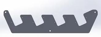

Wednesday I received an email from the fab shop with a pic of the adjusted bracket design for my Mountaineer/Explorer.
One end had to be adjusted because of AC box interference. The bottom was shortened a quarter of an inch from Stephens design and the coils slid up a half of an inch. Also I will be using only 3 holes for the bracket mounting.
(6.5 KiB) Not downloaded yet
(Editing comment: In the HTML or whatever language I can't see why it wants to be downloaded as opposed to showing the pic)

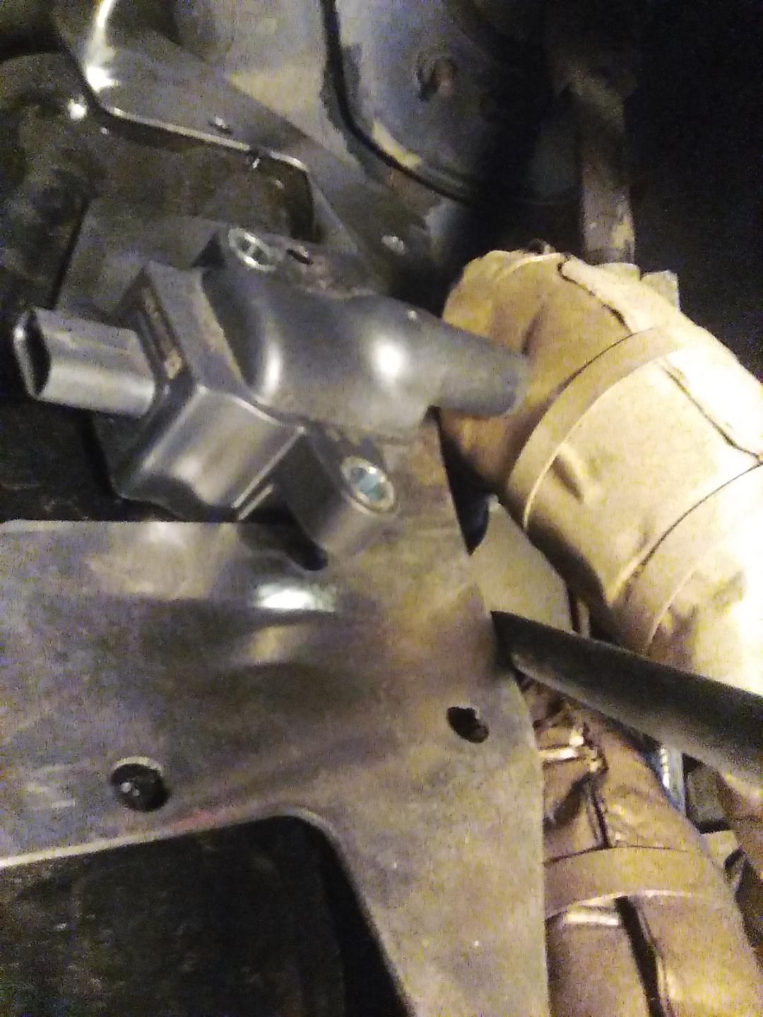

I attempted to use a drawing program to make a file to send to send-cut-send but I couldn't ever get the hang of the program. Fortunately there is a really up to date Fab shop 2 miles from me.
Two weeks back when working with the test bracket, I was having a wacky header issue. One "Godzilla" coil blowing right at a header tube. I have found a temporary solution for the RH side but nor the left, until custom log headers can be fabricated.
Test bracket is touching the AC box and coil too.
