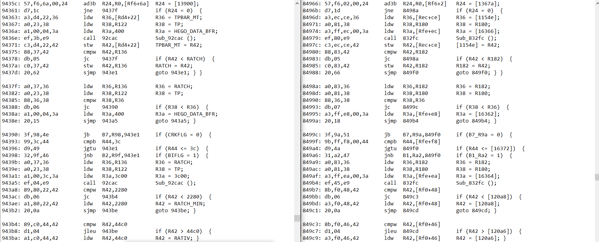

I am slightly confused on the HEGO_DATA_BFR areas here. In the EQE3 lst file there are different addresses (?) for the areas where they are the same in the RZASA lst file. I am assuming that they arent the same and probably not HEGO_DATA_BFR in EQE3?
Posts: 7006
Re: EEC V file conversion
Thats not for the hego its a scalar. Those are obviously the time constant scalars for tp just SAD is assigning the value as an address.
Anytime you have a word assigned as a strict value you don't know if its a value or if it will be used for a lookup later.
TVRFAN- if you can have SAD reference the CMT file to see if that line is assigned a scalar name that would be significantly helpful.

Sorry, I am still slightly confused about this, are you saying that the RZASA lst file is not correct or it does not compare to the EQE3 file properly and I am not on the correct path at all? I'm sorry if these questions seem simple. You guys are very smart about this stuff and I really appreciate all of the help you are giving me.
I dont have a cmt file for the RZASA bin, just the dir file that jsa posted for me to use for comparison. Is SAD not correctly assigning the 400 value in the RZASA file as HEGO_DATA_BFR?
