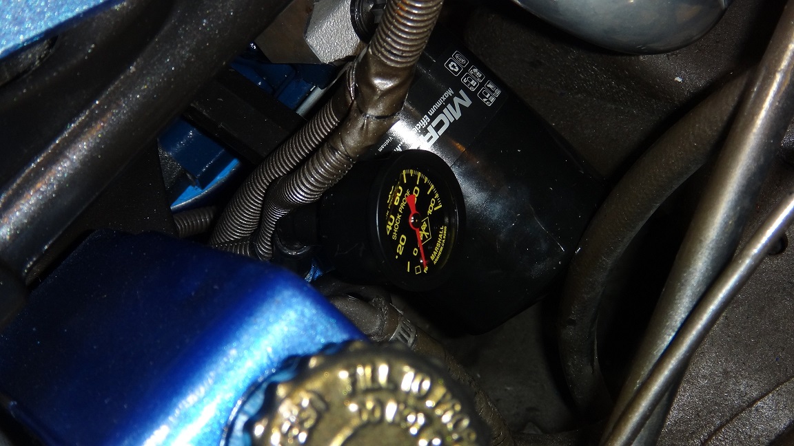

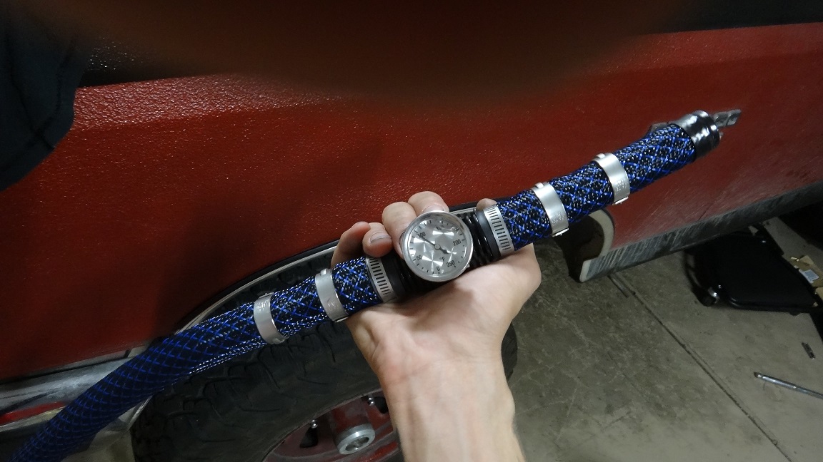

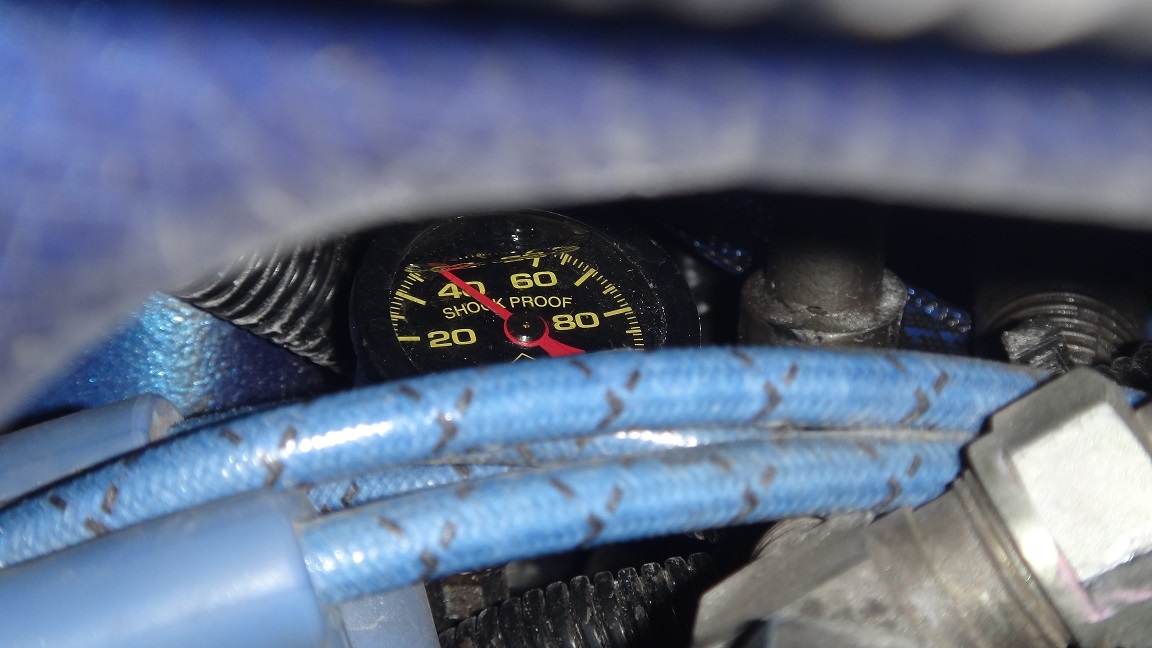

Attached are the oil pressure, inline water temp and fuel pressure gauges I have. OP gauge is tee'd in with the OP sensor on the side of the block, and the water temp gauge is inline just after the water pump. I also have a TV pressure gauge up top for the AOD.
