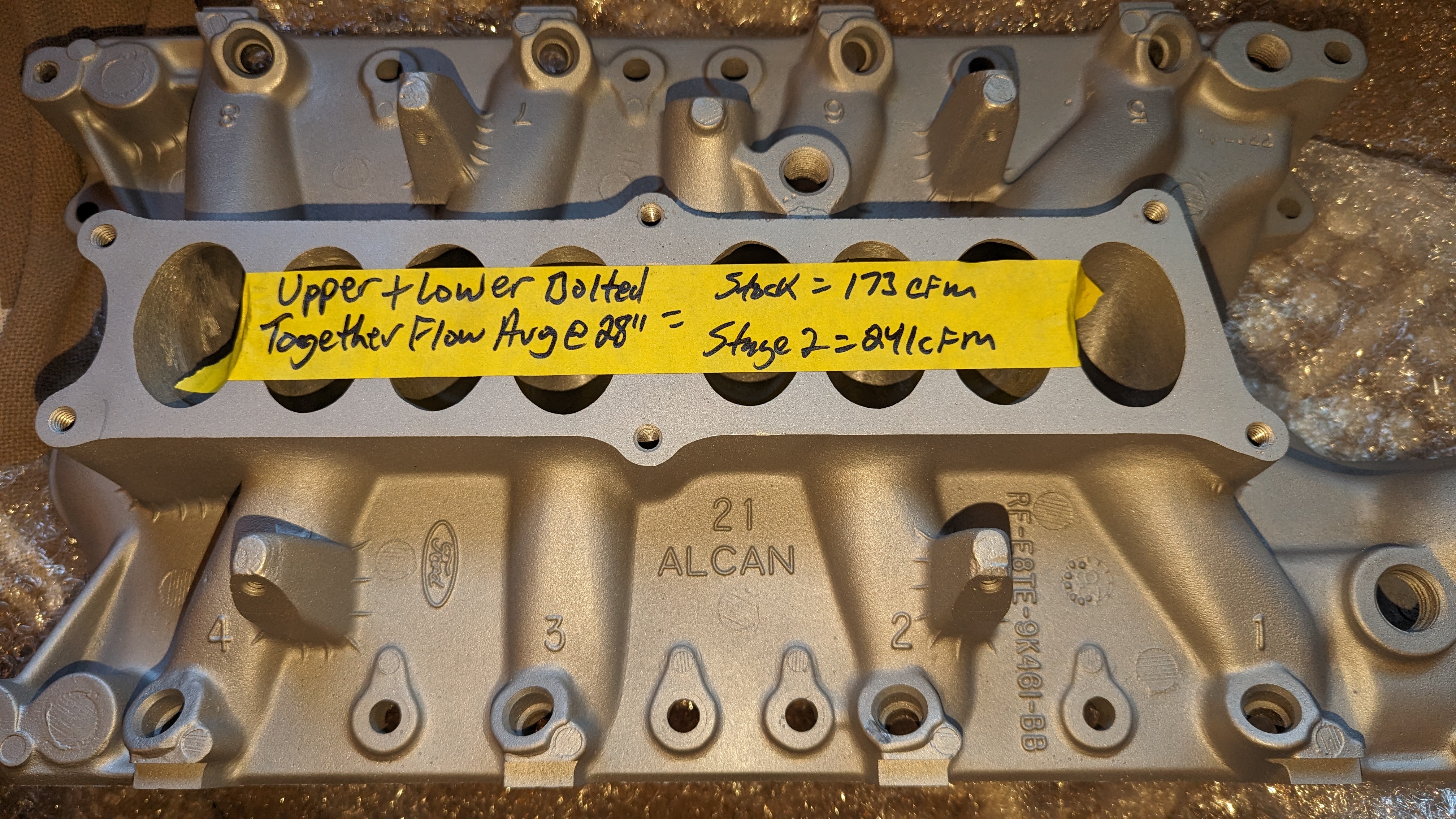

Big dogs is porting my stock upper and lower intake. They can get them to flow ~240 CFM which is nearly what the ported AFR heads flow. I'm pairing it with a 61 mm BBK throttle body.

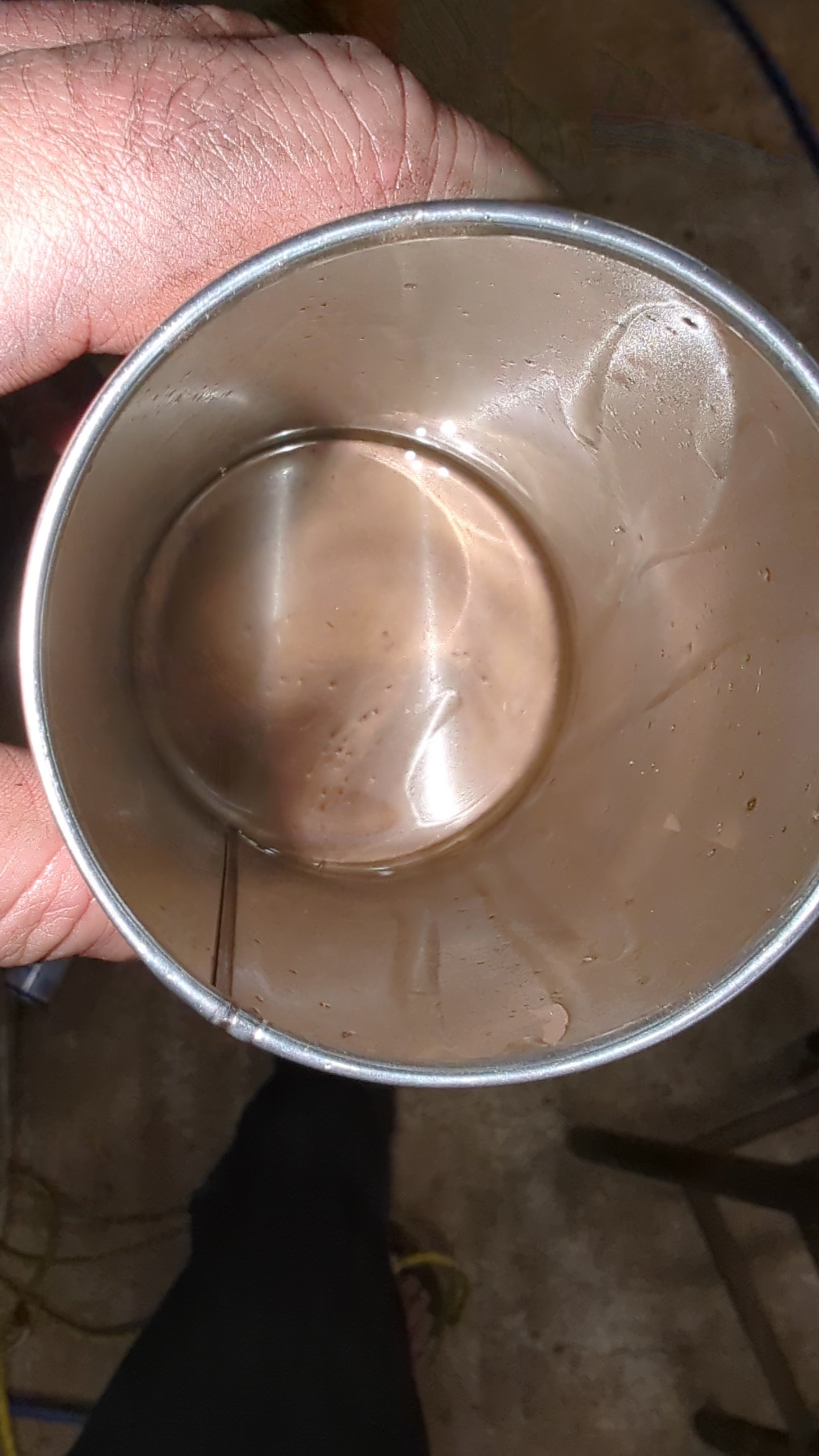

This is not so nice, the first oil change after 1 heat cycle/15 minutes of runtime.
I did another couple of heat cycles after changing the oil and it was less but still more material than I expected. No chunks but the oil has a copper color. Here is what I drained out of the filter after the second/third run.
I am going to pull the engine and inspect. Just looking for moral support. Thanks guys.

What type of distributor gear are you running?
- Posts: 245
Re: 400hp 351w startup tune
It's the factory distributor so cast iron. I believe the copper material is from the thrust bearing. Thinking back to the build, there was no noticeable clearance, so I think that is where I made the mistake. I also have a SFI flexplate and billet converter so I would want more clearance not less. I don't have any experience here but probably not OK to let that wear in, right? I ran the copper oil through a paper towel, and it came right out the other side. It just feels like oil so it's like microscopic dust.

This is the stock iron crank? Worse case letting it wear in is it eats the crank. Which could eventually lead to losing the entire rotating assembly I guess.
Did you measure clearance on the thrust bearing during assembly?
- Posts: 245
Yea stock crank ground 10 under. When assembling I made the mistake of not measuring thrust clearance. When I saw the spec of .004-.008 I knew tight was OK but there was near zero end play. Stupid mistake. It is wearing in for sure but not sure how that will turn out in the long run. At this point the damage is done so I am going to run it and keep an eye on the oil condition. Hopefully it didn't wipe it out too bad. If I keep getting copper in the oil I'll start tearing it apart again. No fun
