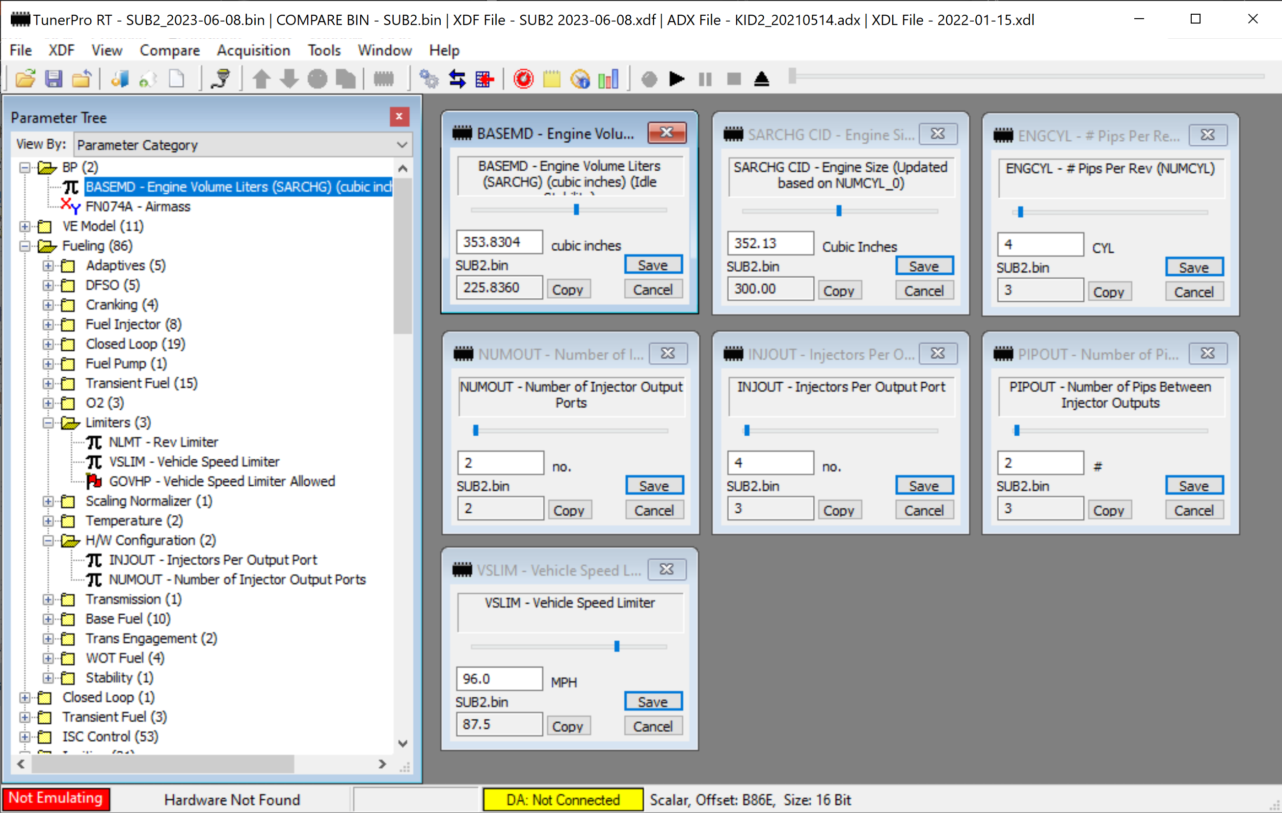

For SD V8 351 users, here is my modified bin.
This is a screen shot of changes going from 300ci 6cyl, to 351ci 8cyl:
- SUB2_V8_351w_2023-06-08.bin
- SUB2 v6 to v8 changes
- (56 KiB) Downloaded 760 times
