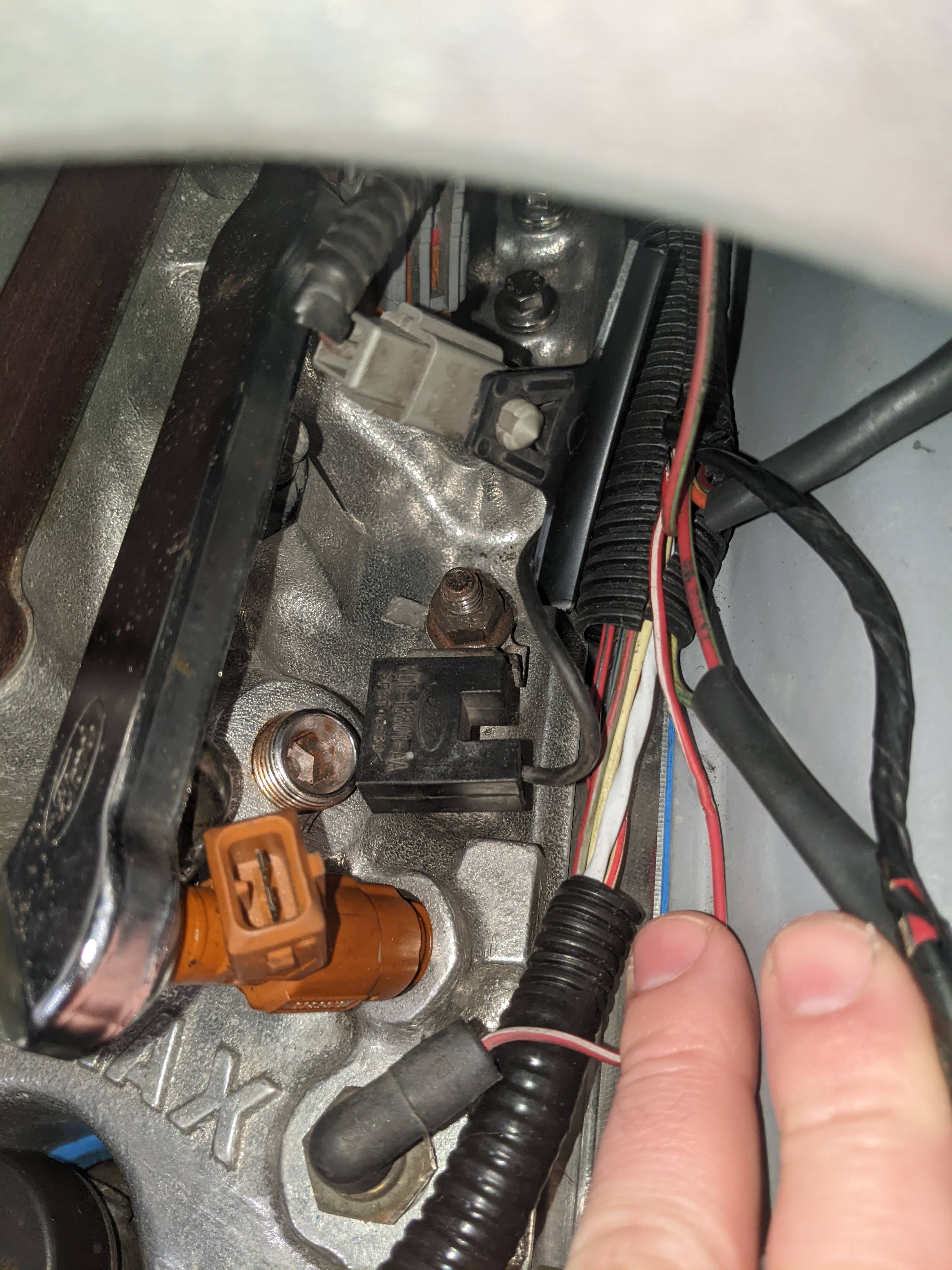

dleach1407 wrote: 2023 Apr 26, 19:23 Can you post a picture of what you are referring to? I think my harness only has 1
