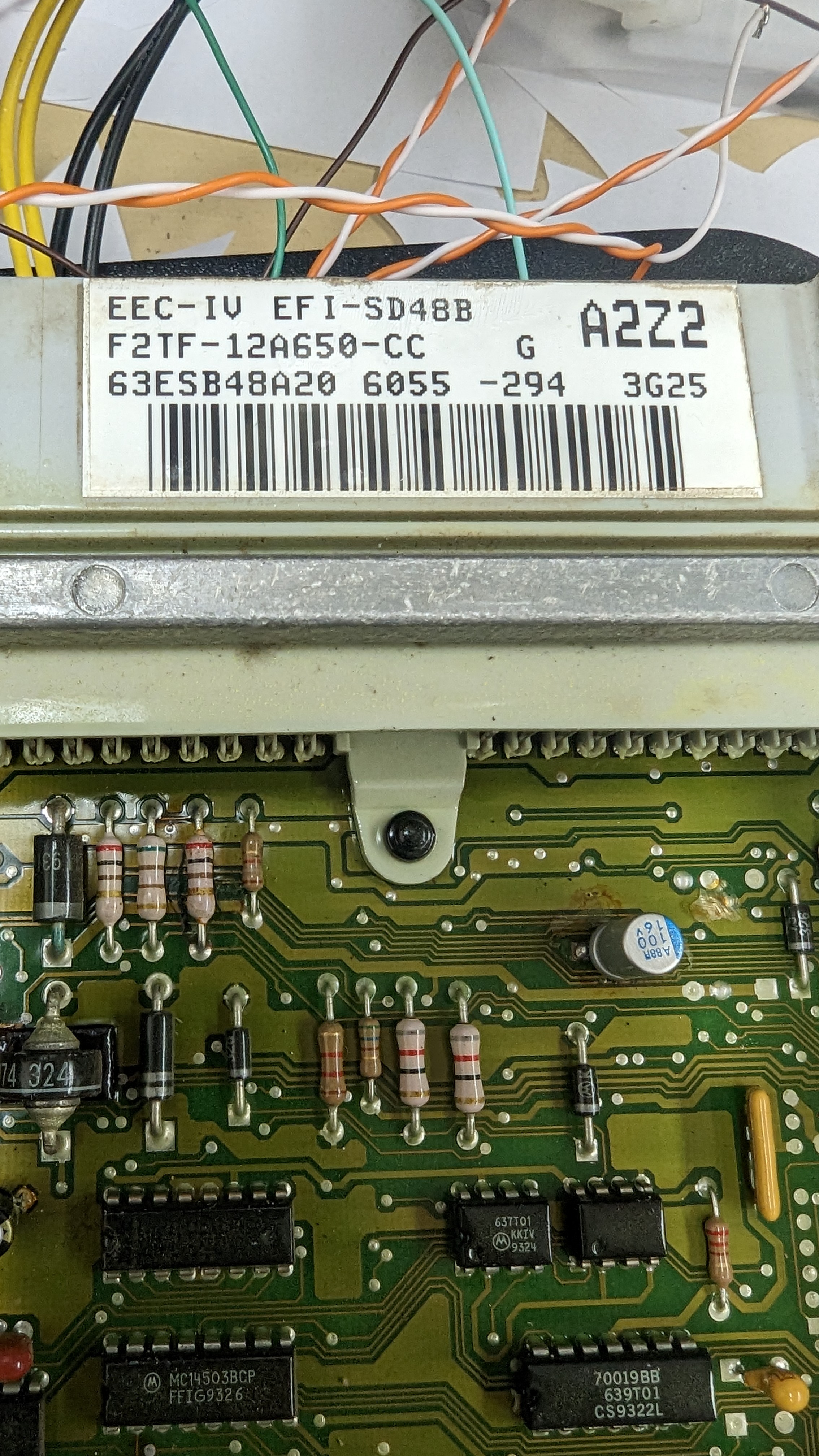

What is the original code on the SD48 hardware you have?

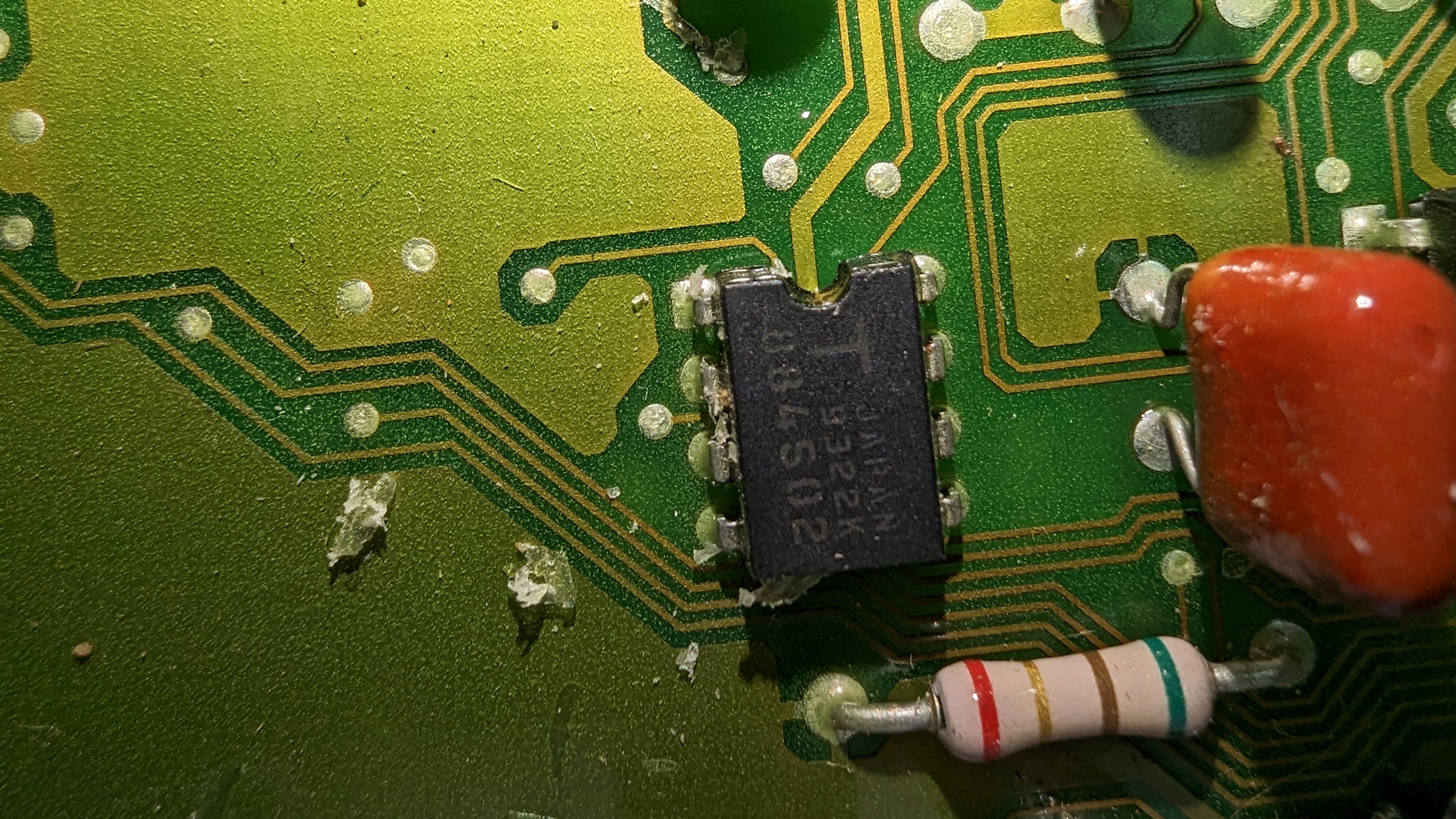

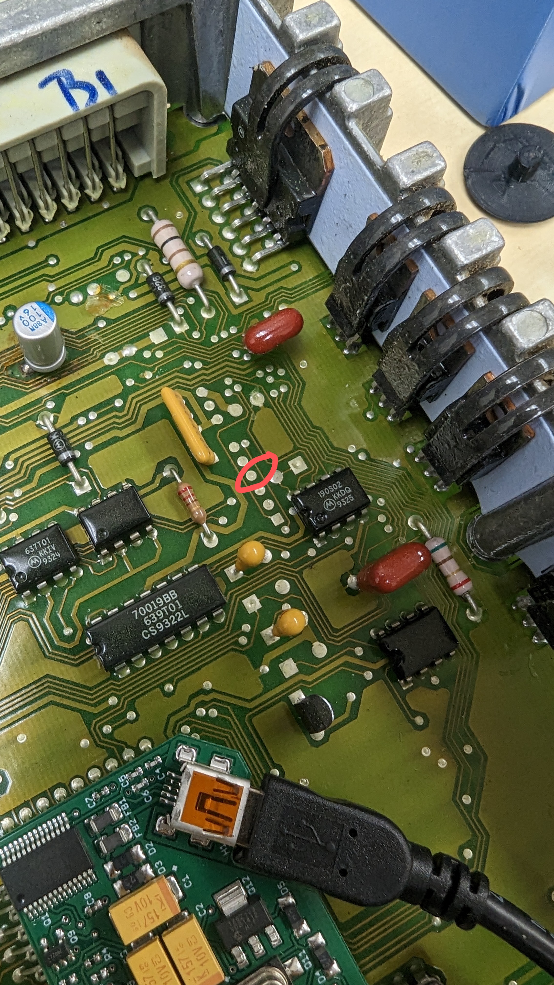

I'll send a pic tomorrow. It is sd48b for sure but don't have the other info. I think pin 39 may be an option but I lost it near the small logic chips in the middle of the board. All the other available pins appear to go nowhere or to missing components.

So pin 39 just needs a couple smd components and connects through this ic.
Any ideas on what this chip is? Are we dealing with the on/off or PWM?

I think that chip is connected to CPU pin#43-AVCC, supply voltage for A/D stuff, I wouldn't go there.
Working backwards from the CPU, looks like CPU pin#21(LSO3), pin#23(LSO1) and pin#26(I/O0) are not connected to anything.
Going to verify in software.
